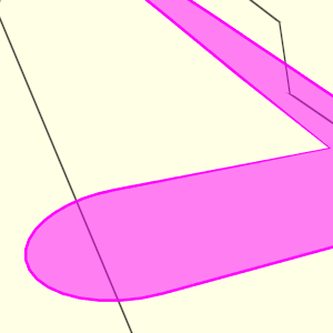

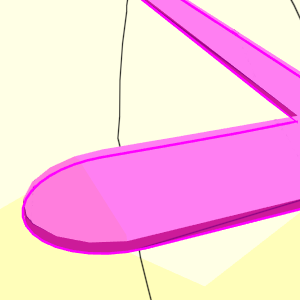

When selected:
one The higher side of the kerb displays as a shaded line.
two The thin line represents the lower side of the kerb.
kerb highlights
This orientation can be reversed using the Reverse Kerb property of the Kerb Properties panel.
