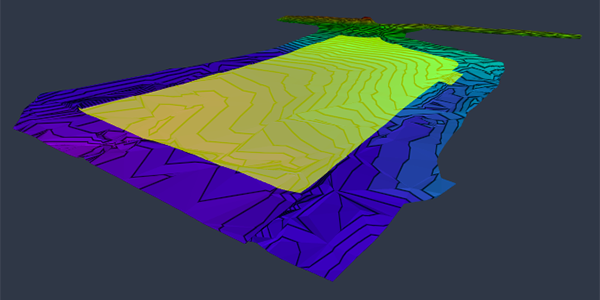

The Grading Limit object is a preconfigured zone that is specifically designed to represent the outermost footprint of your Grading Optimization project. Use grading limits in larger drawings to reduce unnecessary optimisation and improve performance.
The Grading Limit zone has the following object properties enabled: Slope, Breakline and Grading Limit.
