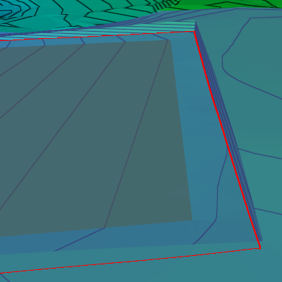

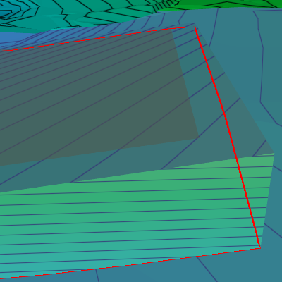

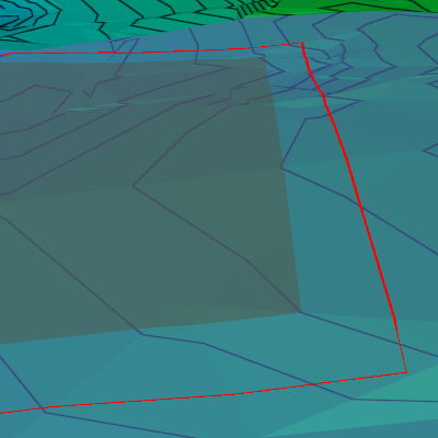

A retaining wall breaks the terrain along the wall linework and steps the terrain within the specified height constraints of the wall.
| As Configured | Optimised | Reversed |
When closed geometry is drawn in a clockwise direction, the terrain will step up along the outside of the geometry. If drawn in an anti-clockwise direction, the terrain will step up towards the inside of the geometry. Either method can be reversed from the Retaining Wall Properties panel.
