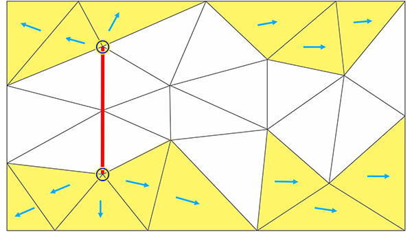

When planning ridge lines, it is important to understand how they work in the optimisation process. In the following simplified example, any triangle with a centroid that is above or below an end point of the ridge line will slope away from the point.

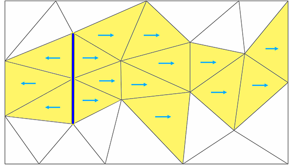

Any triangles with centroids that are not above or below end points of the line will incline away from the ridge line perpendicularly.

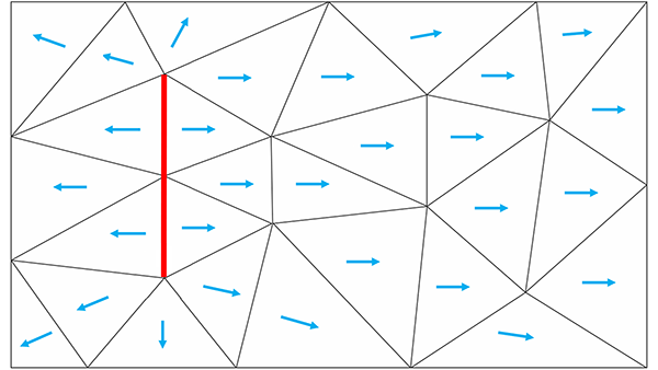

In this example, the intent of the grading looks something like this.

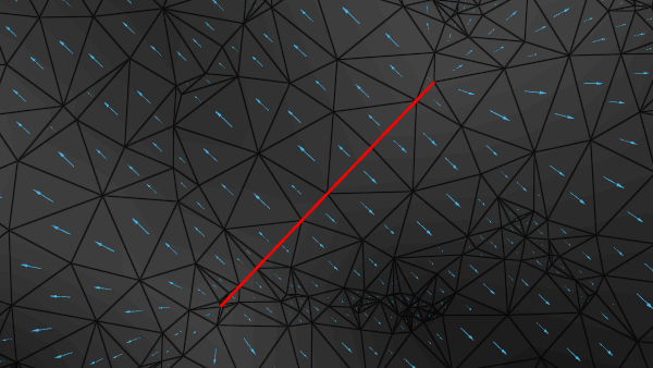

Using the Wireframe theme and Hydrology Direction Vectors in the Visualisation Toolbar, you can better see how Grading Optimisation will attempt to solve the surface grading for ridge lines.
