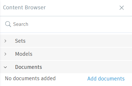

  3. Use the drop-down lists in the Content Browser to select what to include in the package. You can include sets, models and supporting documents.
    • Use the Sets drop-down list to browse the view or sheet sets created in Revit. You can select specific views and sheets or select the sets themselves to include all the views and sheets they contain.
    • Use the Models drop-down list to include RVT models in your package. If any models are contained in a set that has been selected from the Sets drop-down list, they are selected by default.
    Note: You may want to check that your Revit authors have published their latest models and sets to Design Collaboration from Revit, or use the Publish latest option to make sure that the contents of your team space are up to date.
    • Open the Documents drop-down list and then click Add documents to add supporting documents to the package.
      Select all relevant supporting documents from your team's folder. Refer to the Supporting Documents help to learn more about the file types that can be included as supporting documents.

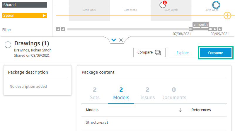

Consume a Package
Consuming a package means that you’ve brought another team’s package into your environment. The goal is not to own or take responsibility for this package, but rather to see it combined with your work and with all other teams’ work. You’ll see the latest model from that team in your Project Model. If you’ve linked into the other team’s model in the Consumed folder, the links are updated as well.
Packages are displayed on the package timeline according to their status and indicate how much of each package your team has consumed.
Tip: It may be useful to explore other team's packages before you choose to consume them.
When you’re satisfied that you understand the other team’s package and you feel that your team can absorb the new changes, you can consume a package.
  1. Expand the timeline and click on the node that represents the relevant unconsumed package.
    Packages that have not been consumed are displayed as empty circles next to other team's lines on the timeline. They may look like any of the following examples:
    Node type Description
    An unconsumed package.
    A mixture of consumed and unconsumed packages.
    Multiple unconsumed packages.
    A mixture of consumed and unconsumed models and packages.
    Tip: You may need to click on the nodes that represent multiple packages several times until you have a single node selected.
  2. Click Consume to bring the deliverables into your team space.
If your Revit authors have linked into another team’s consumed online models, those Revit links are automatically updated in your team’s authoring environment. On the timeline, you’ll see the package node on the Shared line is now filled to indicate you’ve consumed it.

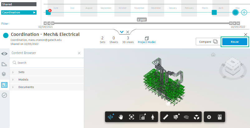

Reuse an Existing Package
If you have an existing package, such as a weekly release that uses similar content each time, you can reuse it as a starter for a new package.
  1. Click on a previously shared node.
  2. Click Reuse to start a new package based on the previous settings.
    The new package automatically selects the latest versions of the models, sets, views, sheets and supporting documents that were previously shared.
  3. Adjust the selections for the new package as required, then click Share to share the package.
