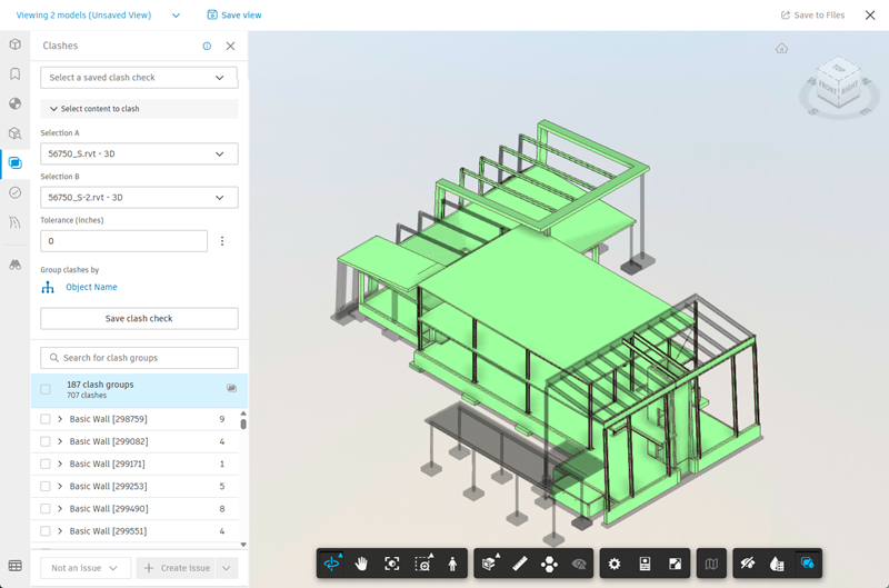

When project administrators first sign in to Model Coordination, they are asked to create a coordination space, specify whether automatic clash detection is turned on or off and select a folder in the Files tool in Forma Data Management to configure it against. Team members with access to the folder can then upload 3D models for review and clash detection.
When 3D RVT, DWG, NWC and IFC models are added to a coordination space with clash detection turned on, Model Coordination's clash service automatically detects any clashes between the objects in those models.
Project members can then review the detected clashes, create clash checks for easy reuse, and either mark clashes as 'Not an issue' if no action is required or create an issue for further investigation.
Project administrators can also manage clash settings after setting up a coordination space, opting individual models or objects in and out of automatic clash detection as required.
