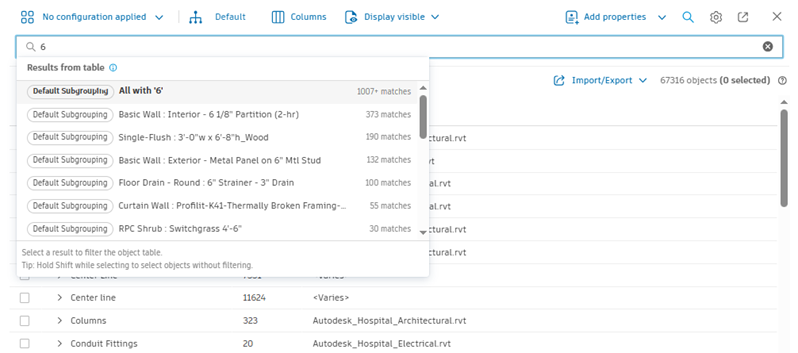

Search the Object Table
You can quickly find and highlight any objects in the table with a value that matches your search term, provided the property has been added as an object table column or grouping. As you type in the search bar, a dynamic drop-down list displays three types of option:
When you select an item from the drop-down list, the object table is temporarily filtered to show only objects matching the search value.
Tip:
To quickly hide all non-matching objects in the viewer, select all objects in the table after searching, right-click anywhere in the view and then click Isolate. To reverse this, right-click again and click Show all objects.

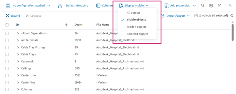

Edit Object Table Display Mode
Choose which display mode to use for the object table to determine which rows are shown. Choose from:

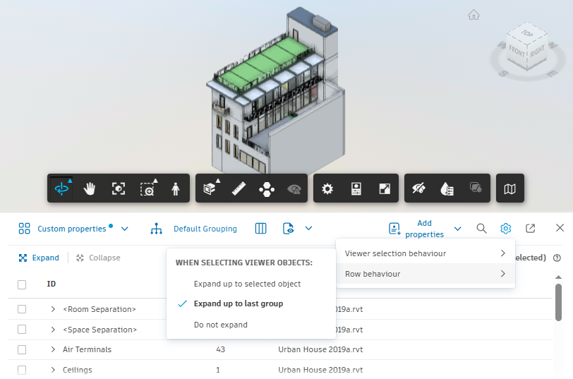

User Preferences
Specify your preferred behaviour when navigating the object table.
Note: These settings are saved and remembered for each individual project member.
  1. Click the User preferences icon at the top right of the object table.
  2. Hover over the Viewer selection behaviour option to see the two settings that control what happens in the viewer when you select objects in the table:
    1. Select the Zoom into selected objects tick box to zoom into objects in the viewer when you select them in the object table.
    2. Select the Isolate selected objects tick box to isolate objects in the viewer when you select them in the object table.
      Note: The Isolate selected objects option is only available when the display mode is set to All objects.
    Note: These settings can be used independently or in combination.
  3. Hover over the Row behaviour option to choose between the settings that control what happens to the rows in the table when you select objects in the viewer:
    • Expand up to selected object – the object table expands the rows to the level of the selected object.
    • Expand up to last group – the object table expands the rows to the level of the group that the selected object is in.
    • Do not expand – the rows in the object table don't expand when objects are selected in the viewer.
    Note: These settings don't apply when using Shift+Select to select multiple model objects.

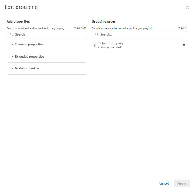

Custom Object Table Groupings
Members can create custom groupings up to ten levels deep using any available model property as a grouping property, including extended properties.
  1. Click Default at the top of the object table.
    All available properties are displayed on the left in groupings. These include a grouping of Common properties that you can add.
    You can scroll or search for properties.
  2. Click to expand groupings and click the + next to a property to move it to the right and add to the grouping.
  3. Click the trash can icon to remove a property from the grouping as necessary.
  4. Drag properties you've added to reorder the grouping hierarchy.
  5. Click Apply.
    Note: If you remove all properties from the grouping and click Apply, the object table will revert to a flat list named Not grouped.

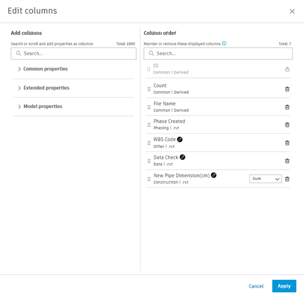

Edit object table columns
You can add and reorder the object table columns from a list of all model properties available in the current view, including extended properties:
  1. Click Columns at the top of the object table.
    All available properties are displayed on the left in groupings. These include a grouping of Common properties that you can add. All properties currently added as columns are displayed on the right.
  2. Click to expand groupings and click the + next to a property to move it to the right and display it as a column.

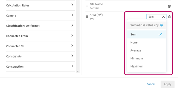

  3. For properties that contain numerical data, optionally select the way the data is summarised in grouped rows. Click the drop-down list next to the property name and choose from:
    • Sum – displays the sum of all the values in the grouping.
    • None – the values are not summarised. If all the values in the grouping are the same, then that value is displayed. If the values are distinct, then 'Varies' is shown.
    • Average – displays the average of all the values in the grouping.
    • Minimum – displays the smallest value in the grouping.
    • Maximum – displays the largest value in the grouping.
  4. Click the rubbish bin icon to remove a property as a column as necessary.
    Note: You can't remove the Name property from the object table.
  5. Drag columns vertically in the list to reorder them.
  6. Click Apply.
