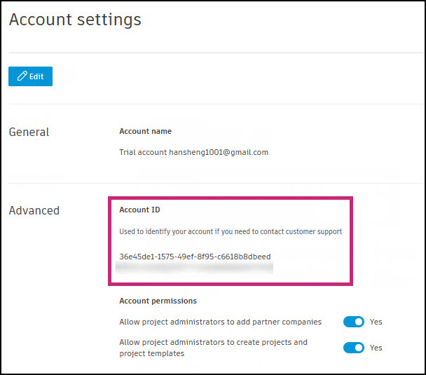

For support-related purposes or for connecting Customised Integrations (only for enterprise accounts), you need the unique Autodesk Construction Cloud account ID. To view:
