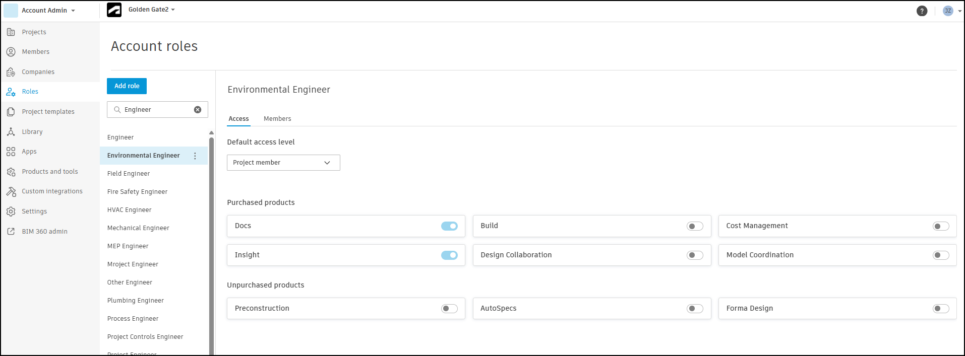

Roles streamline workflows, permissions and access. For example, you can make a role Submittal Manager in the Submittals tool or assign a permission level to a file or folder in the Files tool. Roles can also define access levels; for example, all Architects could be project administrators. Roles are created by account administrators in Account Admin.
Roles control product access. Setting up roles before inviting members can ensure that all of your members have access to the products and tools they need when they access a new project. A person with multiple roles will get the access of the combined roles. For example, if a person has the role of Project Administrator and Submittal Manager, they will have the access of both roles.
Roles are listed in alphabetical order on the left. Selecting them can allow you to change their settings.

Create Roles
In the Roles tool within Account Admin:
  1. Click Add role.
  2. Provide the name of the role to add.
  3. Click Add role.
  4. Select the Default access level.
