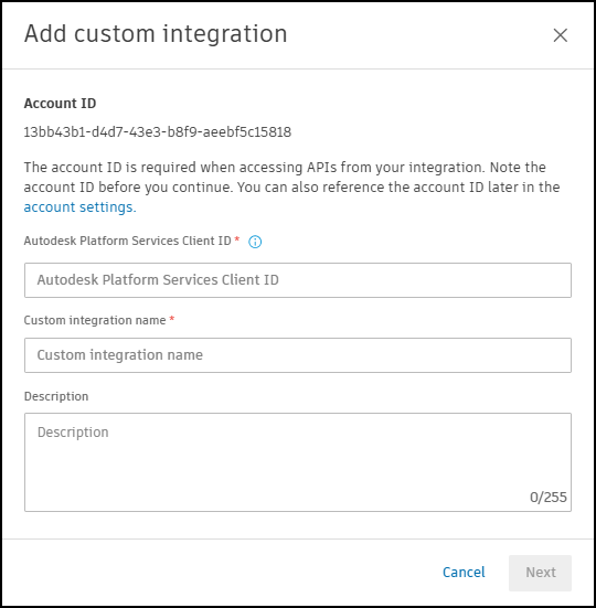

- Click Add custom integration in the ‘Custom integrations’ tool.
- Provide your APS Client ID. The Client ID is the unique identifier for your custom integration. You can find the Client ID in the APS portal.
- Provide your integration name.
- Provide an integration description.
- Click Next.

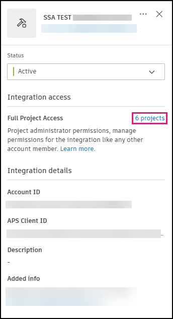

Selecting a custom integration from the list in the Custom integrations tool will show details about the integration, including its access level. The highest level of access that the integration has across all projects is shown here. For example, if the integration has full access to one of your projects, but restricted access to another project, the integration access will still be "Full Project Access".
To view details on the access level of an integration on a per-project basis:
- Select the integration from the integration list in the Custom integrations tool.
- Under "Integration access", Click the number of projects link.
There are three possible access levels, each meaning the following:
- Full Account Access:
- No associated SSA, so the integration has access to account-level data (as opposed to only project-level). The available account data is what is accessible by public APIs. This applies to integrations created before SSA support. If the integration was created in the BIM 360 UI and the access was limited to Admin or Document Management, the setting continues to be respected. The integration doesn't have access to the service that was restricted. In this case, the integration can use two-legged authentication. The Integration email field is empty.
- An associated SSA has been granted "Account Administrator" access in your account. The integration email field is populated. The integration using the SSA acts as an automation user and has the permission in user context only, which can be used as part of three-legged authentication.
- Full Project Access: The SSA attached to the integration is a Project Administrator to at least one project.
- Project Access: The SSA attached to the integration is a Project Member to all projects it has been invited to.
