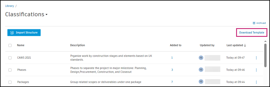

  1. From Account Administration, click Library in the left navigation.
  2. Select the Classifications card to open the Library Classifications page.
  1. Click Download Template to download the XLSX template and use it to build your classification structure.
    • Enter the codes, names and hierarchy that your teams need.
    • Follow the instructions and formatting provided by the template to ensure a successful import.
  2. Import the completed XLSX file back into Library by clicking Import Structure.
  3. A preview screen will display your structure. Here, you can adjust the title and add a description so it’s clear how and when this structure should be used.
  4. Click Save to finish creating your classification.

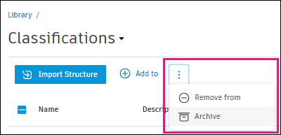

To archive a classification structure in Library:
  3. Tick the box to the left of the classification structure you want to archive.
  4. At the top of the classifications list, click the More (three dot) menu and choose Archive.
  1. In the Archive classification structure modal, click Archive to confirm.

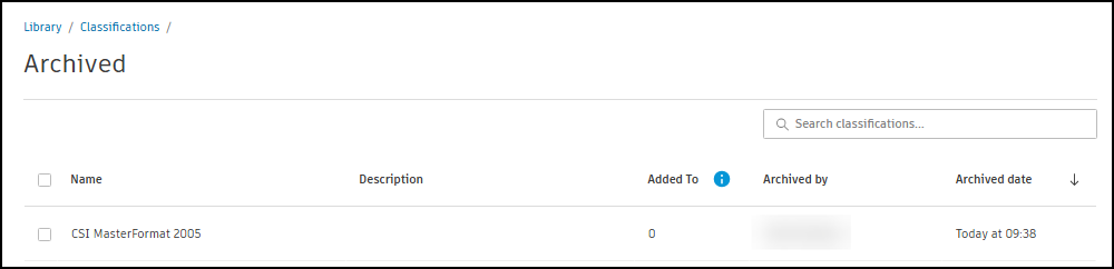

    Your archived classification structure will now appear on the Archived list. Click the Archived link at the upper right of the Classifications page to view archived structures.

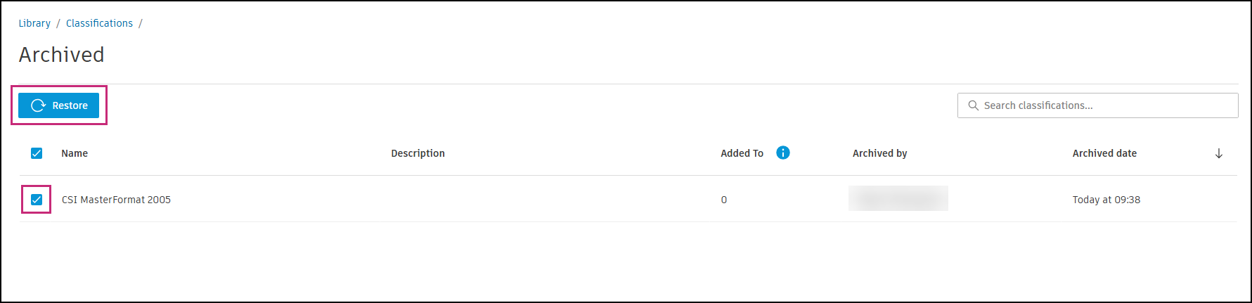

To restore an archived structure in Library:
  3. Click the Archived link at the top right of the Classifications page to open the archived list.
  4. Tick the box to the left of the classification structure you want to restore.
  1. Click the blue Restore button at the top left of the list.
  2. Click Restore in the modal that opens to confirm.
    The classification will now move out of the archived list and back into the active library where it can be managed and applied to projects.
