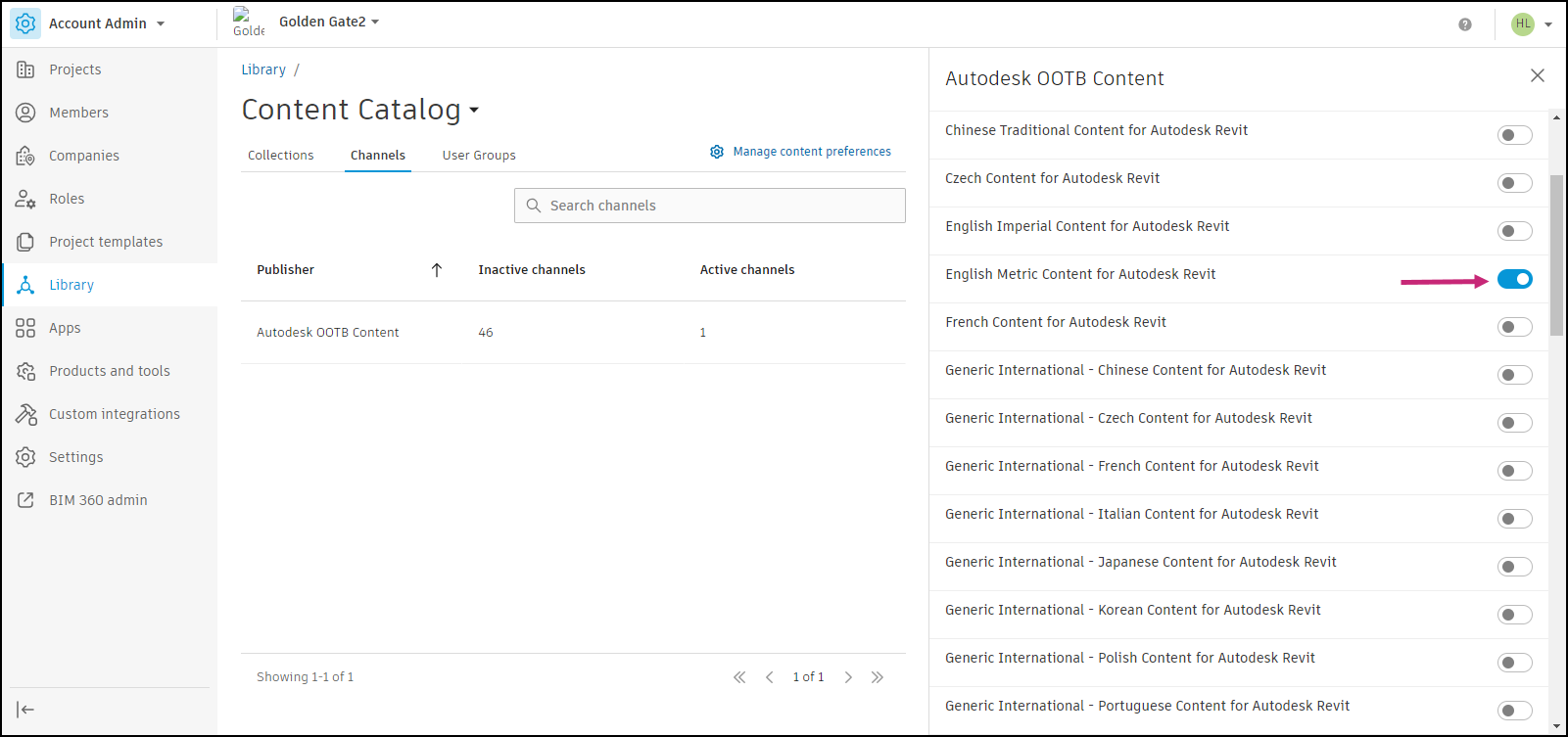

  1. In Account Admin, navigate to Content Catalogue in the Library.
  2. Click the Channels tab.
  3. Click Autodesk OOTB Content.
  4. In the flyout panel, you'll see a list of all the available content that administrators can subscribe to. Click to toggle on and subscribe to any content that you are interested in.
    Toggle on channels
You can see the number of channels you are subscribed to in the Active channels column.
The channels you subscribed to will now appear in your Collections tab.

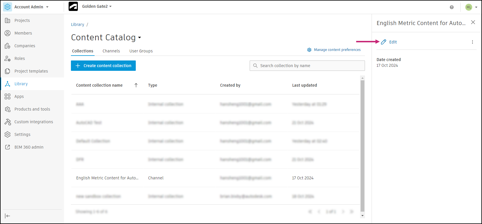

  1. In the Collections tab, click a channel.
    Tip: The Type column indicates whether a collection is a Channel you subscribed to or an Internal collection your team created.
  2. Click Edit in the flyout panel.
    Edit channel

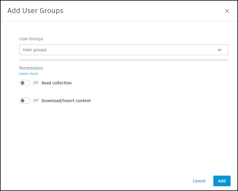

  3. Click Add user groups.
  4. Select user groups from the drop-down menu. User groups are created in the User Groups tab. Learn more
    Add user group
  5. Toggle on the permissions for the user groups. Learn more about permissions.
    Note: Read collection and Download/insert content are the only options available for channels. You may give your team access to review a channel's content to find opportunities to update your own company's standards or make the channel's content available for your team to download.
  6. Click Add.
