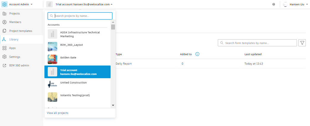

Parameters on the service are organised under an Autodesk Construction Cloud account. In the upper left section of the page, click on the account name and a drop-down menu will show all the accounts you have access to.
Parameters account dropdown menu

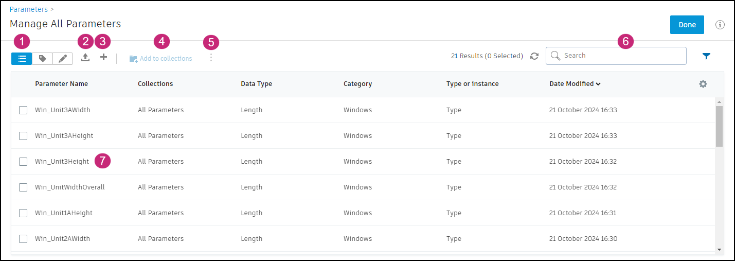

Navigate to the Library in Account Admin. In the Parameters tab, click Manage all parameters.
Use the numbers on the following screenshot and find the matching information. Learn how to view, create, edit, export and archive parameters:
Manage all parameters interface
  1. Views
    • List view : Default view where you can select parameters to edit. Use the cog icon on the far right to edit the columns that appear in this view.

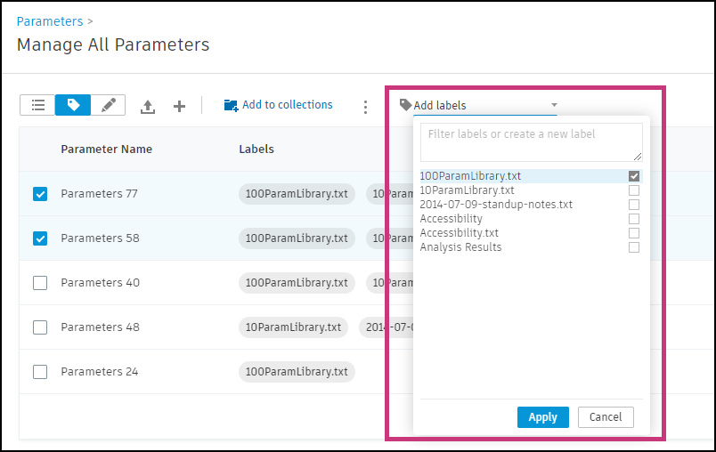

    • Labelling view Labeling view icon: In the labelling view, you can organise your parameters by attaching labels to them.
      You can review the labels assigned to the parameter and remove any unnecessary ones.
      1. Select one or more parameters in the table.
      2. Next, use the Add Labels flyout to attach or detach labels on the selected parameters.
        Parameters labelling view interface
      3. Type in the text box to search for labels or to create labels. To create a new label, click the box next the label. It applies to the selected parameter and becomes available for other parameters.
      4. Select the X at the end of the label name to remove it from that parameter.
    • Edit view Edit view icon: Use Edit view to edit each parameter's category, type/instance and properties palette group. You can select multiple parameters to make multiple edits at the same time.
    After making edits to the selected parameters, click Apply to commit your changes or click Discard to cancel your changes.
    Tip:
    While in Edit view, sort parameters by Category, Type or instance, or other columns to see parameters that may be missing data.
  2. Upload to Parameters Service: Upload a shared parameter file from your computer to load into Autodesk Parameters Service. Learn more
  3. Create parameters: To manually create a parameter, select the + button. You must fill in the name and data type.
    Note: Parameter names can't contain these symbols:
  4. Add to collections: Select the tick boxes next to parameters in the list and click Add to collections. Select collections that you want to add these parameters to and click Add.
  5. More menu More menu icon: tick the boxes next to parameters in the list and click the menu icon for various options:
    • Remove from collections: removes parameters from collections that they are part of. In the pop-up window, select the relevant collections and click Remove.
    • Export: Download a Revit shared parameter text file with the selected parameters. In the pop-up window, click Export.
    • Archive: In the pop-up window, click OK.
      Note: You can restore archived parameters using this same menu and selecting Restore.
    • Restore: Only available for archived parameters.
  6. Search and filter for parameters
    • Search: Input your query in the box on the upper right of the Manage All Parameters window. Parameters are searched by name.
    • Filter: activate the filters panel from the filters icon Filter parameters icon to the right of the search box. You can filter parameters by property palette group, discipline, data type and category. You can also toggle to filter the list by certain characteristics like instance parameters, hidden parameters, archived parameters and more.
      Use the Save this search button in the bottom-right corner of the filters pane to save the current search for later use.
      Switch to the Saved Filters tab to recall or delete a saved search.
  7. Edit existing parameters: click the parameter name and the Parameter Properties window opens on your screen.
    You can change the following data for a parameter:
    • Category bindings
    • Property palette group
    • Type vs Instance
    • Description
    • Hidden Flag
      Note: Parameter Name, Discipline, Data Type and Read Only Flag are not editable after the creation of a parameter.
      Click OK to save your edits.
