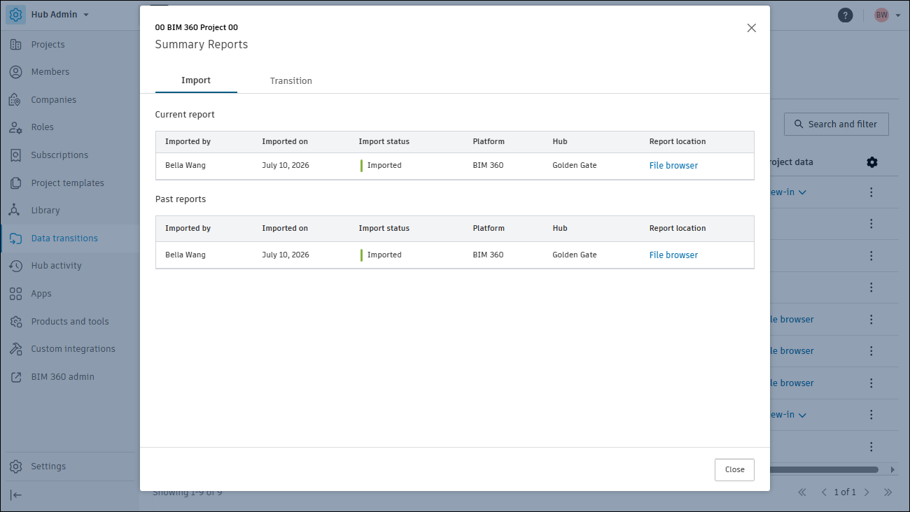

    The page contains two tabs:
    • Import: Tracks data imports into Forma Data Management.
      • Current report: Displays the most recent import, with details about who imported the data, the import date, the import status, the source platform, the hub and a link to the report location in the File browser.
      • Past reports: Lists previous imports, using the same columns as the current report.
        Tip: Click Close to close the page.

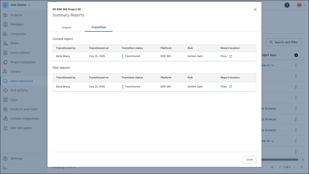

    • Transition: Tracks data transitions into Forma Data Management, including the current and past transition reports.

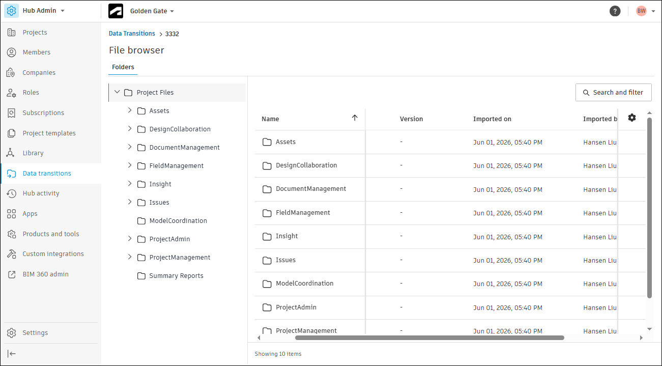

About File Browser
The File browser shows where Forma Data Management stores the data files imported during a transition. Use it to browse a project's folders, locate summary reports and download source files.
To open it, navigate to Hub Admin > Data transitions, select a project and open the File browser. The breadcrumb above the page title shows the selected project.
Find and Customise
  1. Click Search and filter in the upper-right corner to narrow the file list.
  2. Click the Settings icon above the list to show, hide or reorder columns.

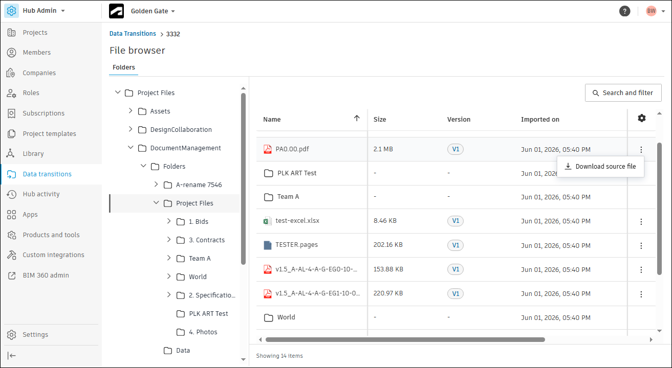

Download a Source File
  1. In the folder tree, select Project Files > Summary Reports.
  2. Click the More menu next to the file, and then select Download source file.

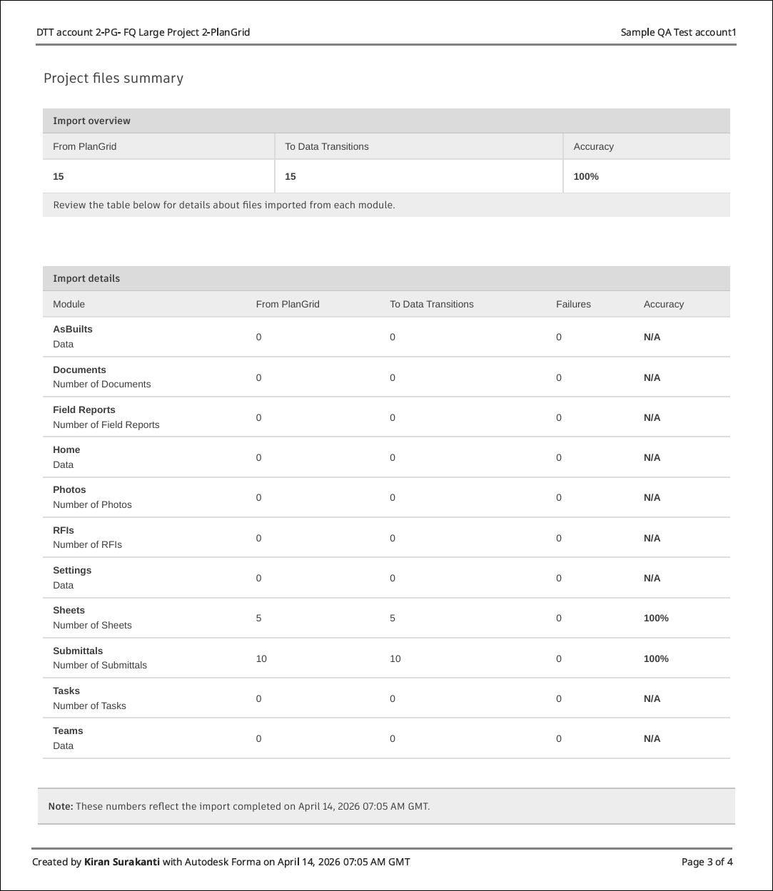

    The downloaded summary report shows the data imported into Forma Data Management, broken down by module. Use it to confirm the import completed and to identify modules with failures.
