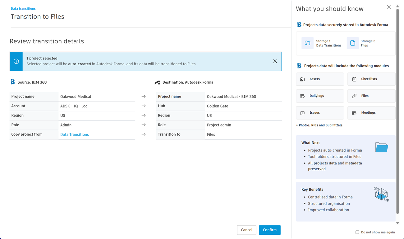

Transitioning a project takes two steps. First you import the project, then you transition the data to create an active project in Autodesk Forma.

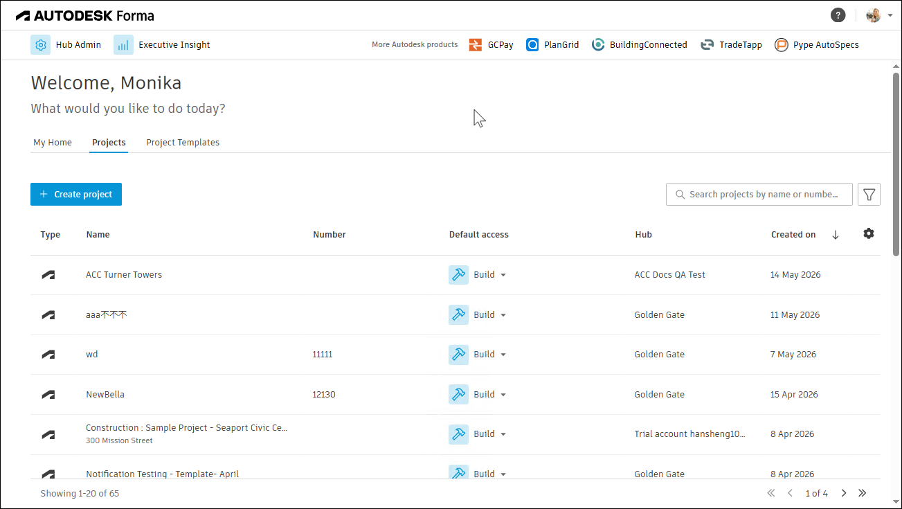

The data transition process is done in the Autodesk Forma Hub Admin.

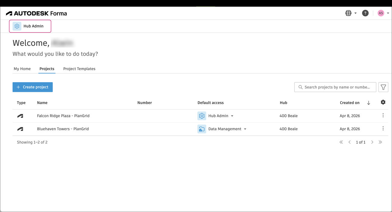

  1. From the project list select Hub Admin.
    Hub Admin in the project list

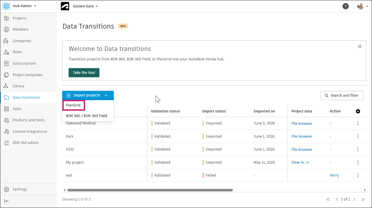

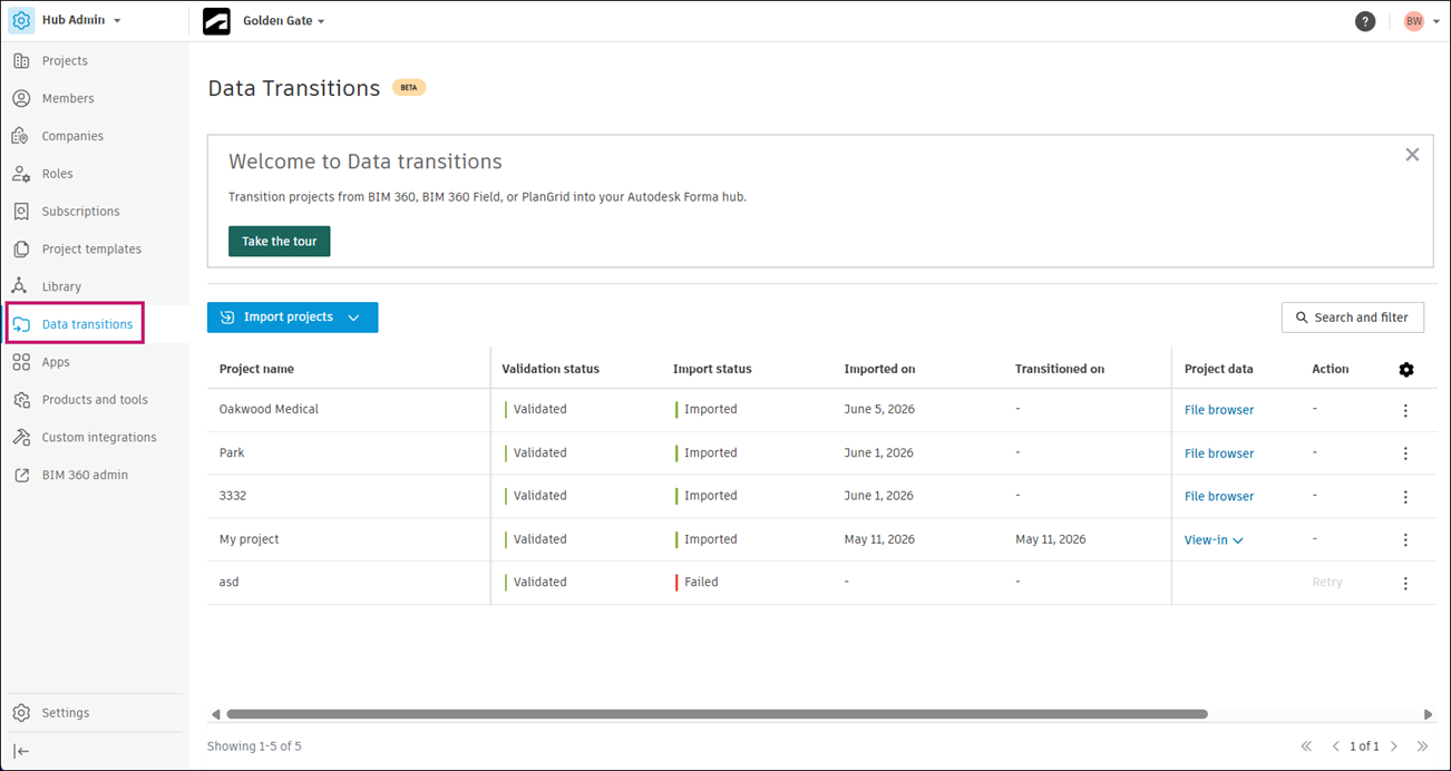

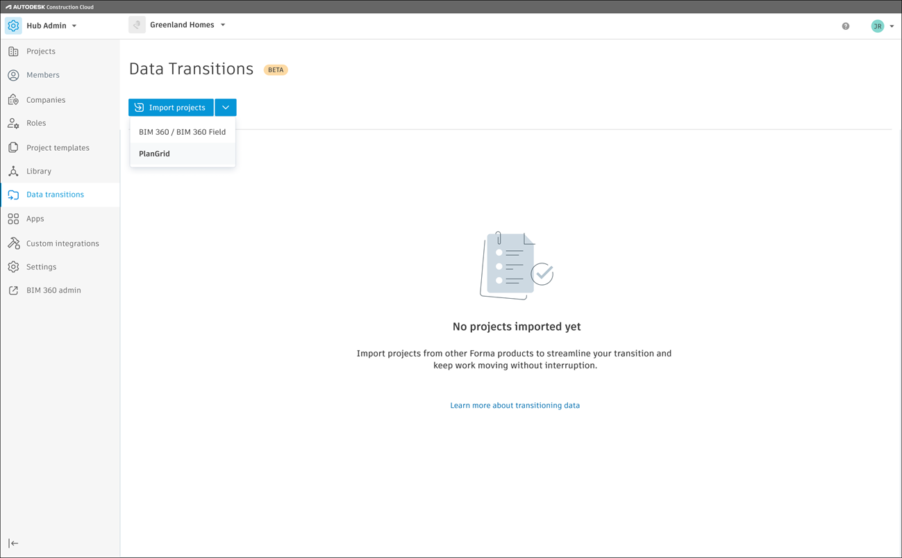

  2. On the left side, select Data Transitions.
    Data Transitions in Hub Admin
  3. Click Import projects, then select PlanGrid.
    Import projects drop-down with source options

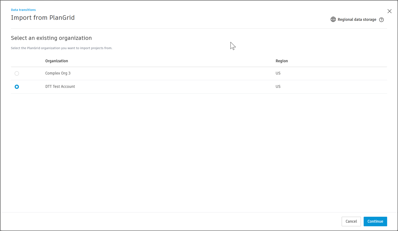

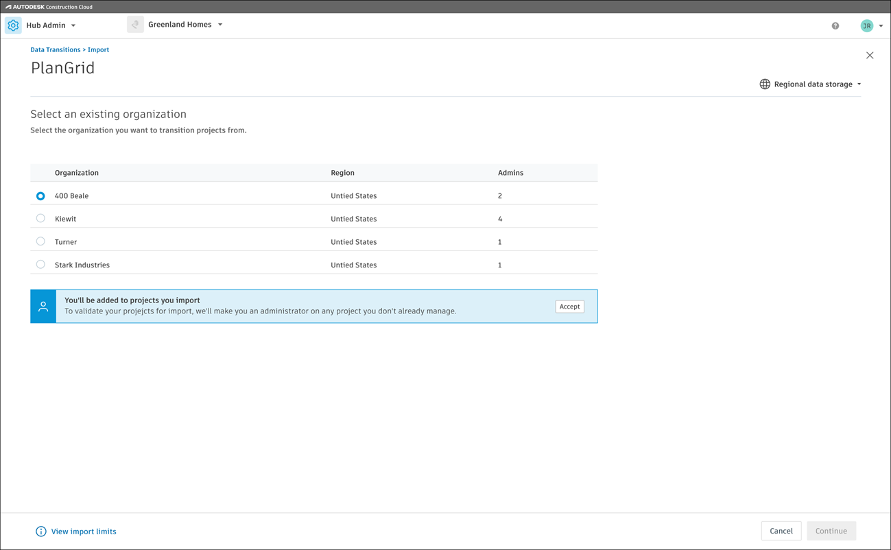

  4. Select an existing organisation.

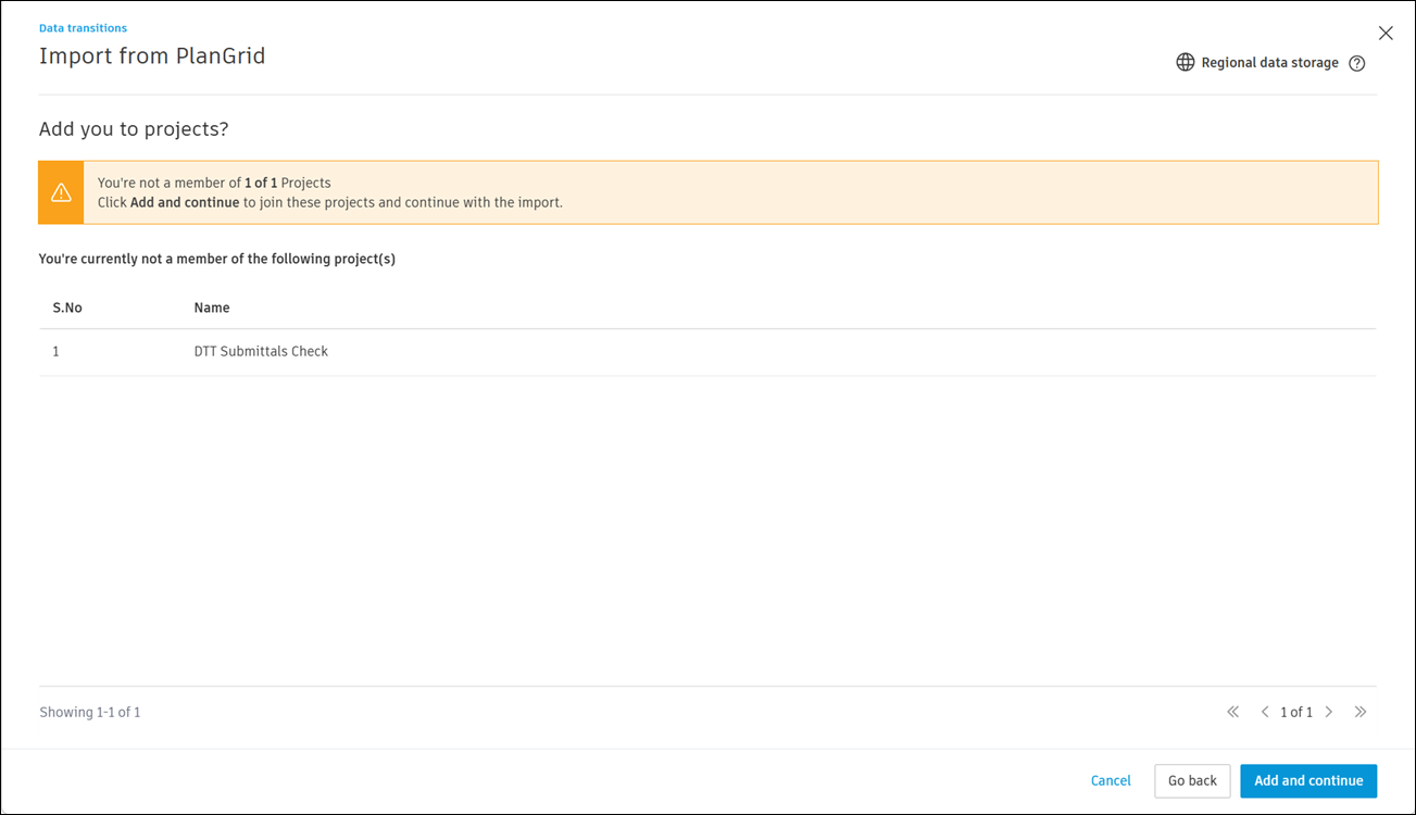

Note: To continue, you need to allow the system to add you as a project administrator to projects that will be transitioned.
  1. Click Accept on the administrator notice, then click Continue.

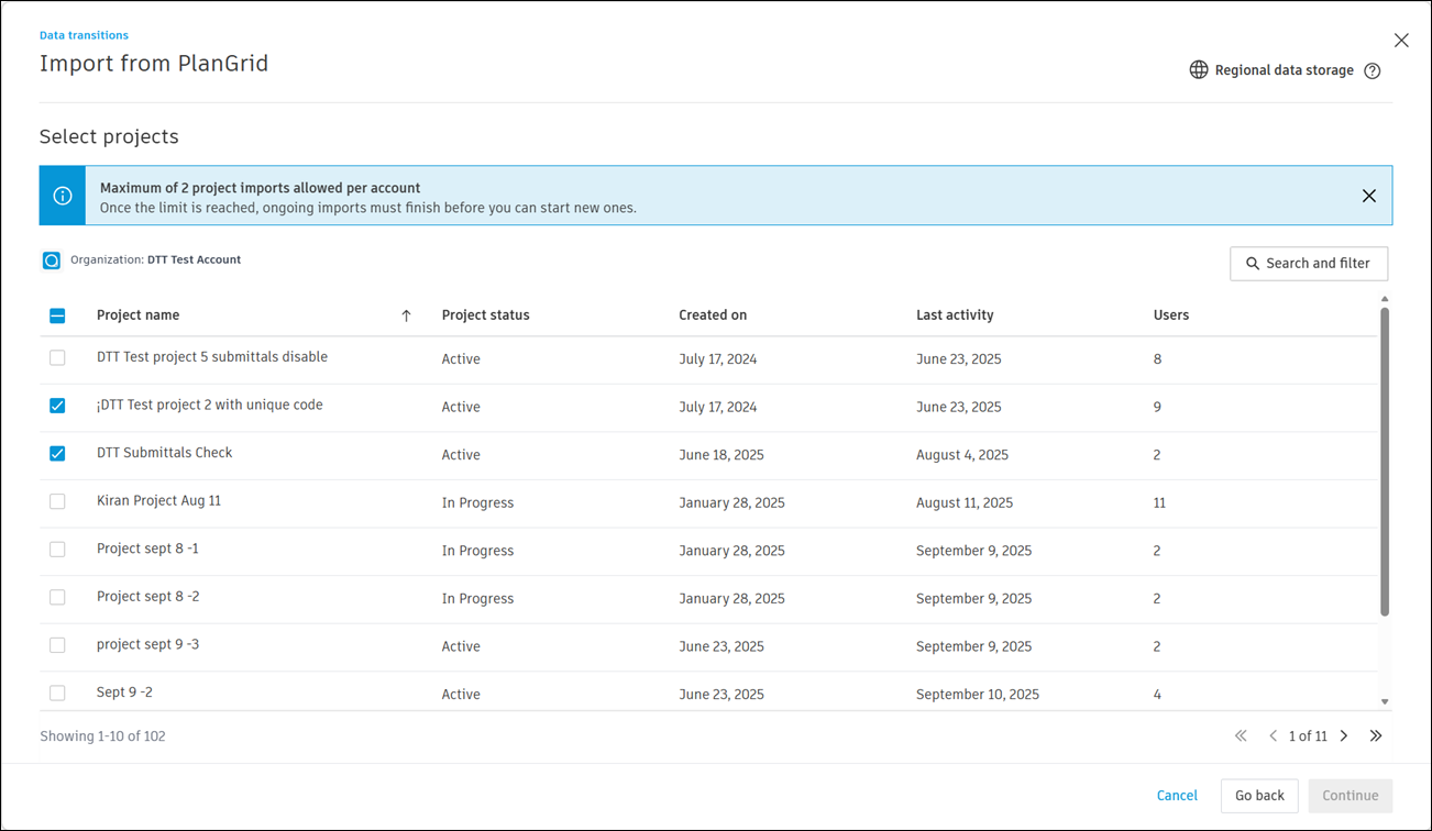

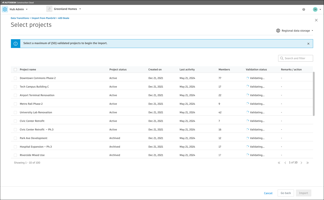

  2. Review import limits, then click Done.

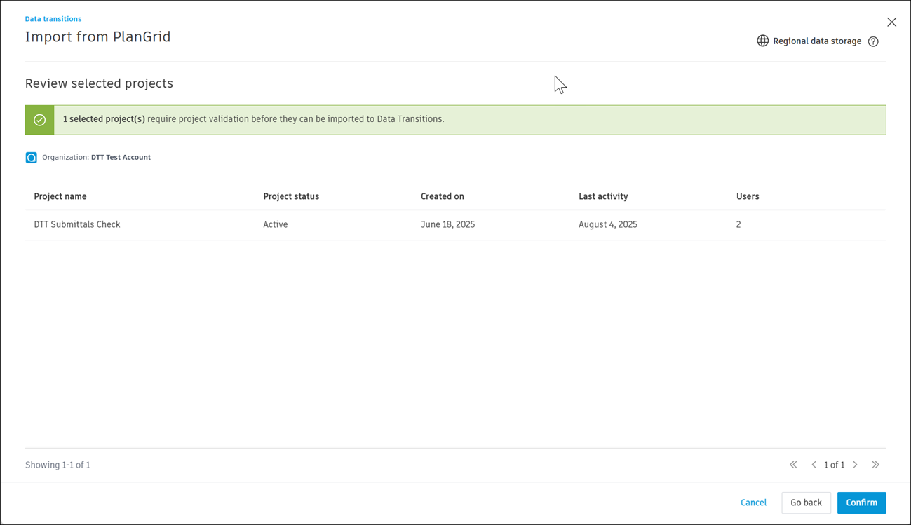

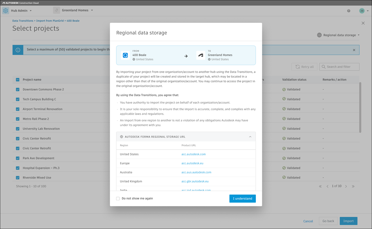

  3. Select the projects you want to import and click Import.
    Tip: To narrow the list, use the Search and filter field. You can select up to 50 projects to import.
    Project validation status list

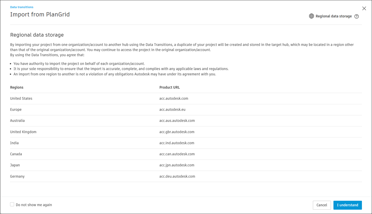

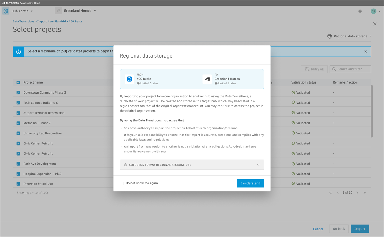

  4. Review the regional data storage notice, then click I understand.
    Regional data storage confirmation

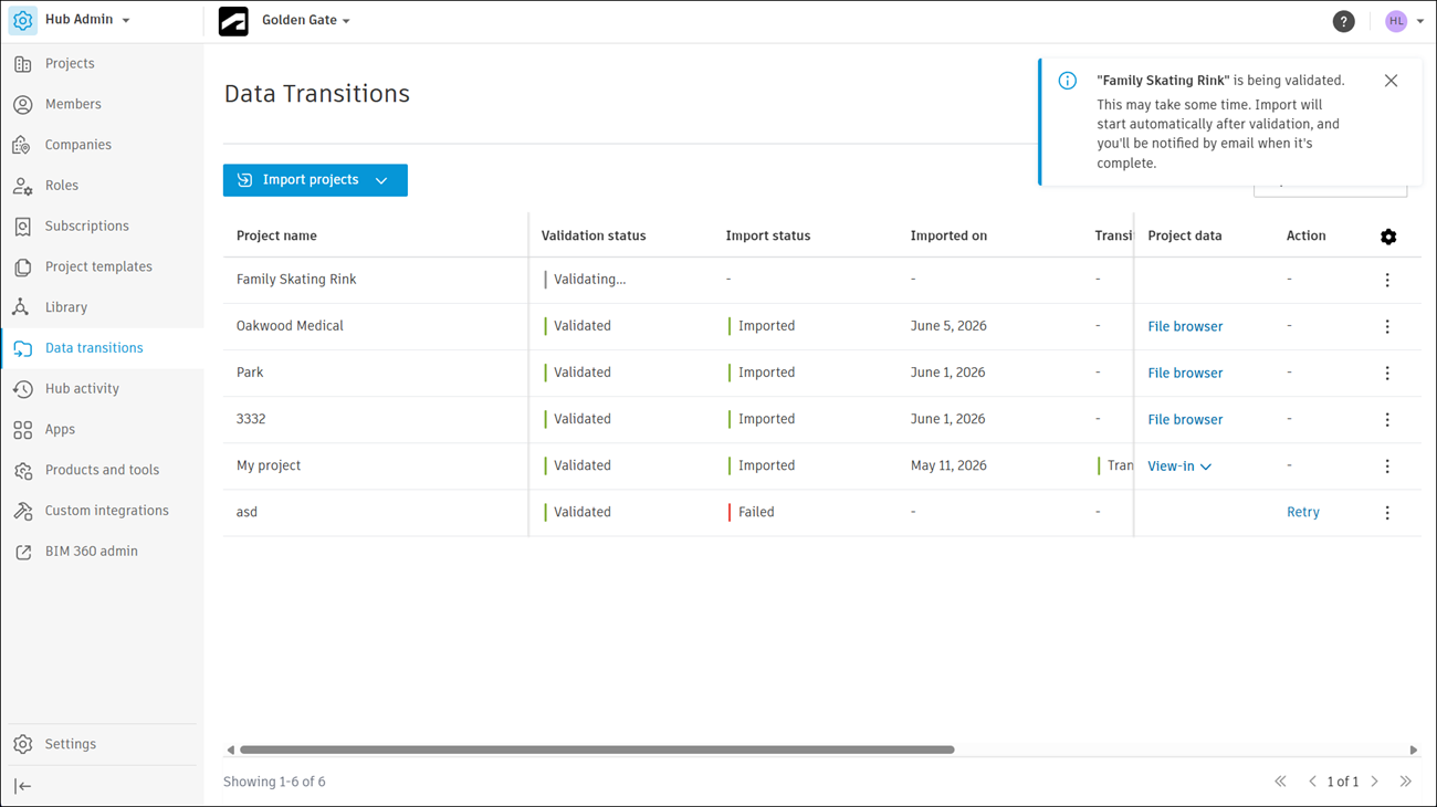

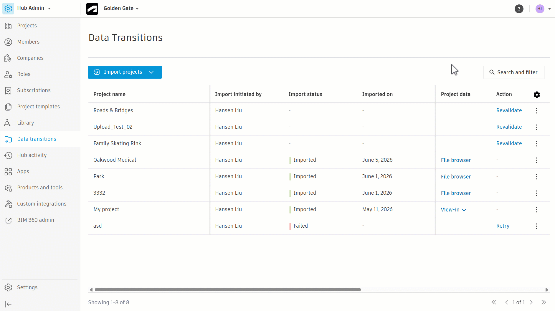

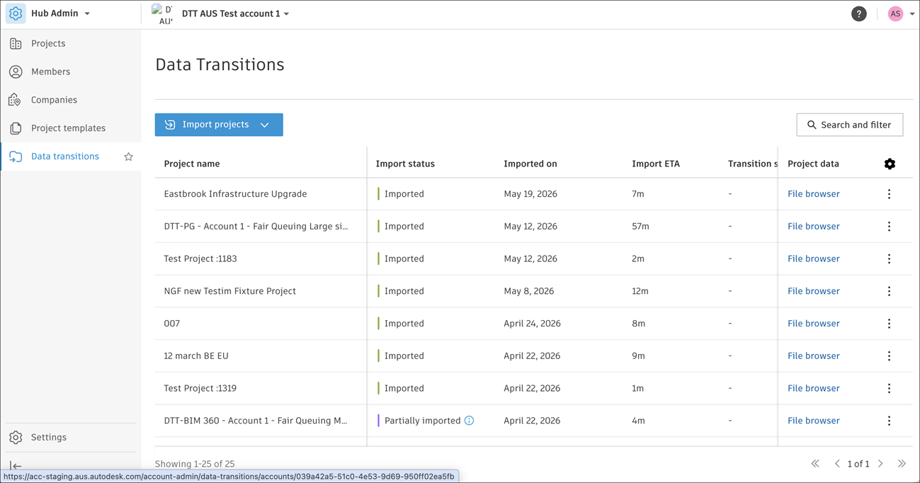

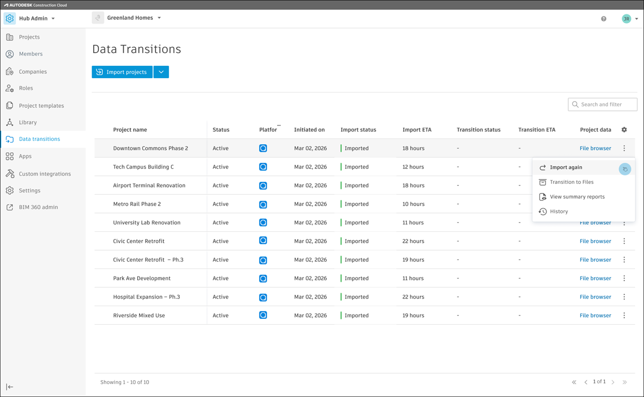

The import will take some time to complete. There are some system checks before the import starts. You can track progress with the Status column.

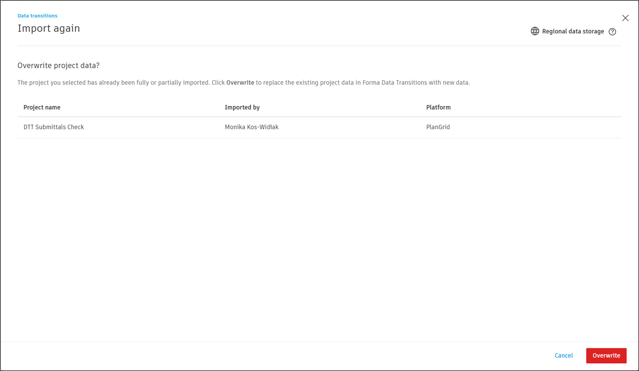

After you have imported a project, select the More menu More menu icon to see the available actions:
Import Again action in the More menu

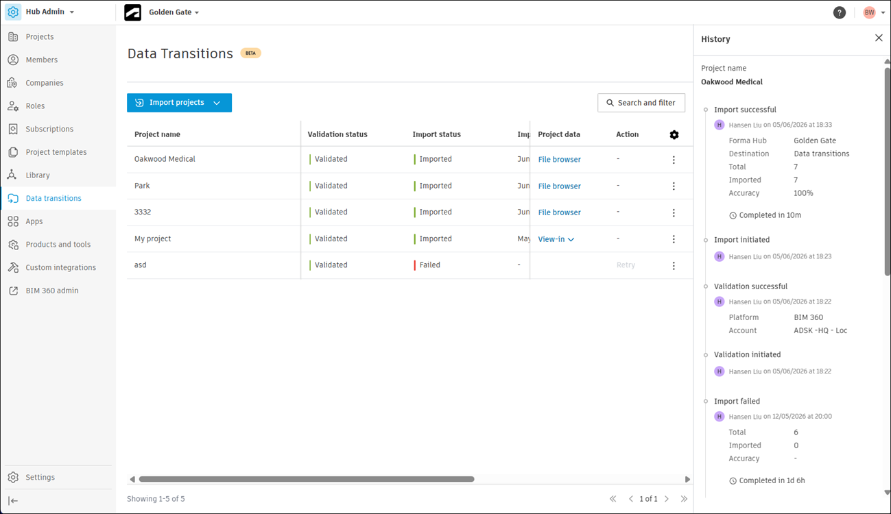

Import Email Notifications
When an import finishes, you receive an email for the outcome:
Data Transition Statuses
There are a few stages that a project goes through during the data transition process. While importing the project, there is a validation and an import stage. Once the import is complete, you can see your project data using our file browser. You can also transition the project to become an active project in Autodesk Forma. The following lists the statuses that you may see throughout the process.
