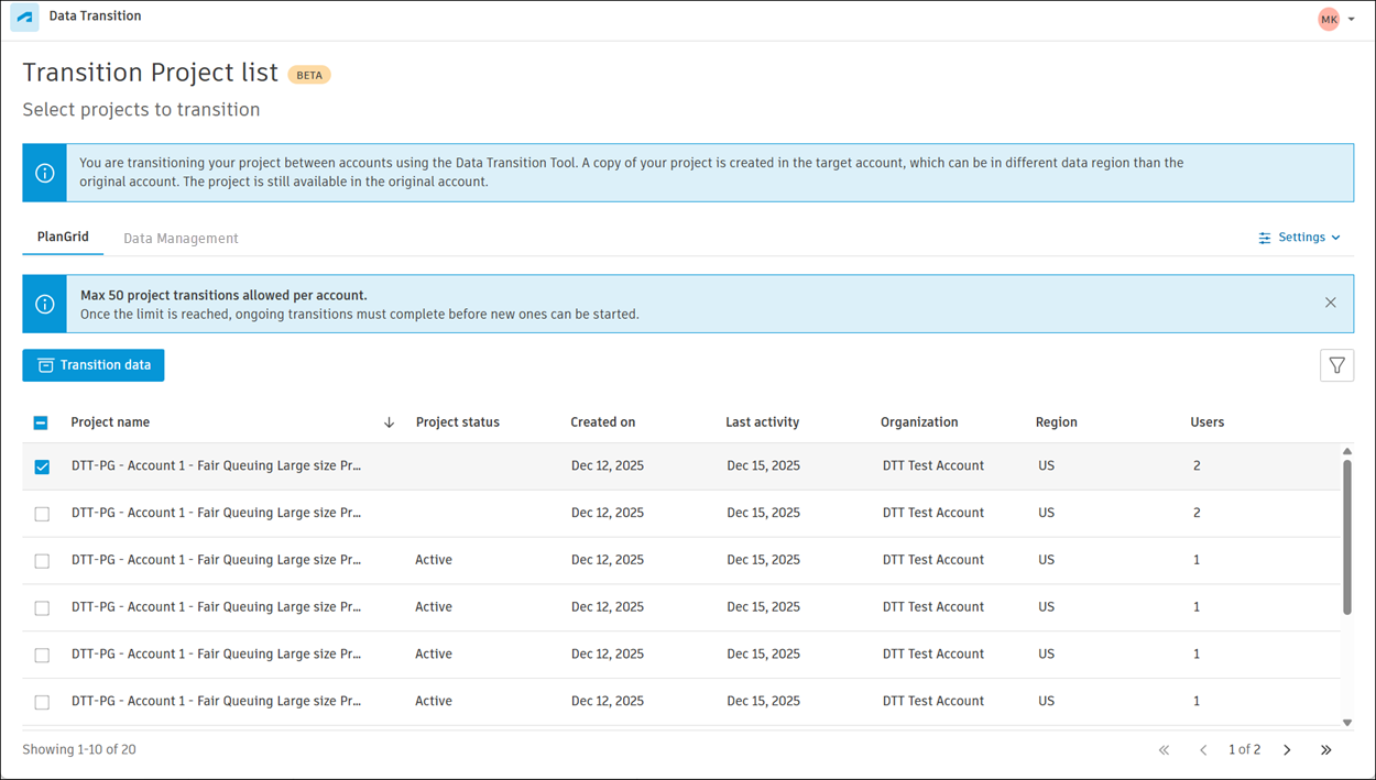

When you enter the Data transitions tool, you'll see a list of projects available for data migration.
Project List
Note: If a transition has failed, you can transition the project again through the More menu More Menu next to the project name.

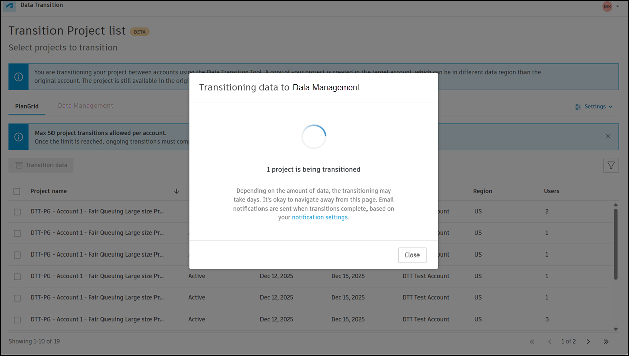

To transition your project data:
  1. Select the projects you want to transition by ticking the boxes next to the project name.
  2. Click Transition data .

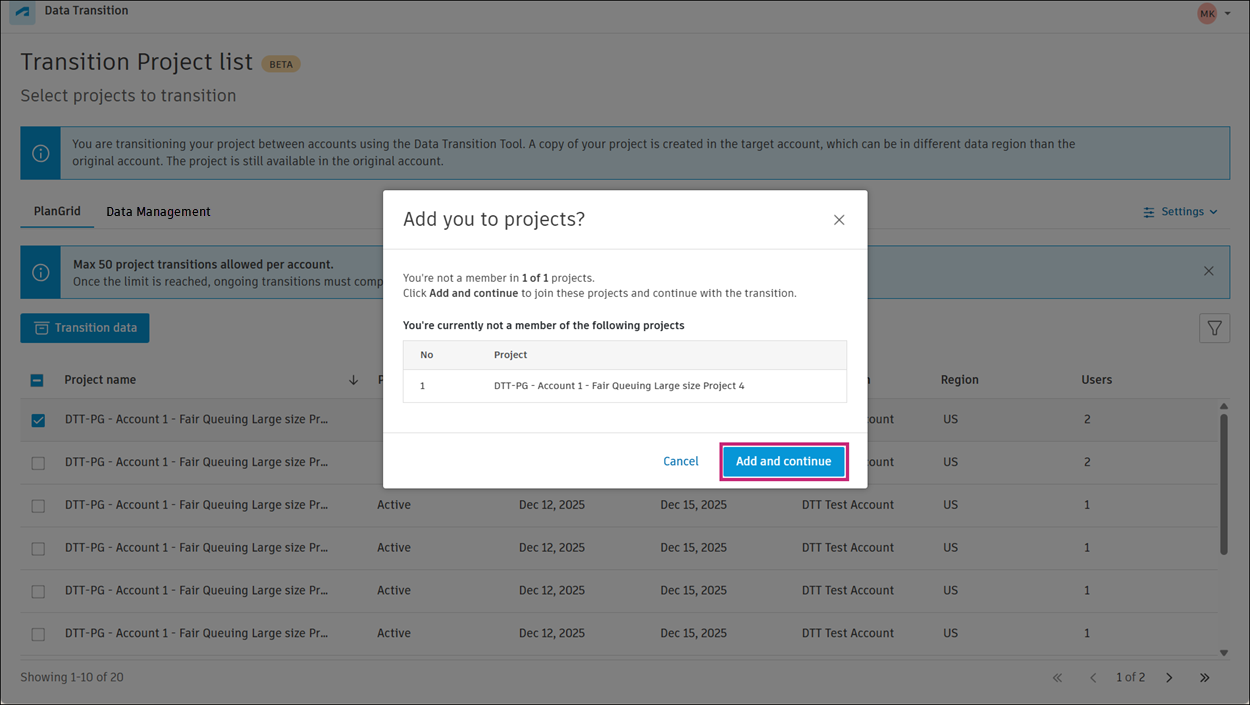

  3. In the modal that opens, click Add and continue.
  4. Select the Autodesk hub to host the moved data from the drop-down menu, and click Continue.

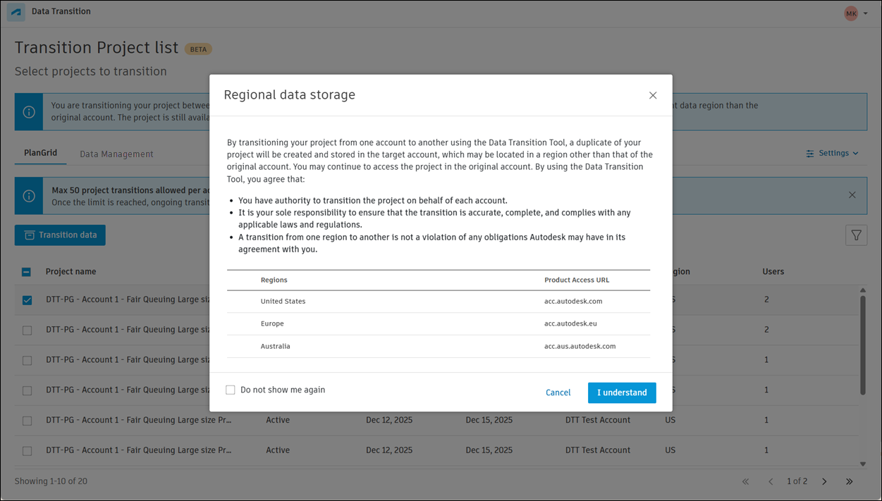

  5. Review content in the Regional data storage modal, and click I understand or Cancel, depending on your decision.
  6. Depending on the size of the project, the data transition may take some time. You will receive a notification when the migration is complete.

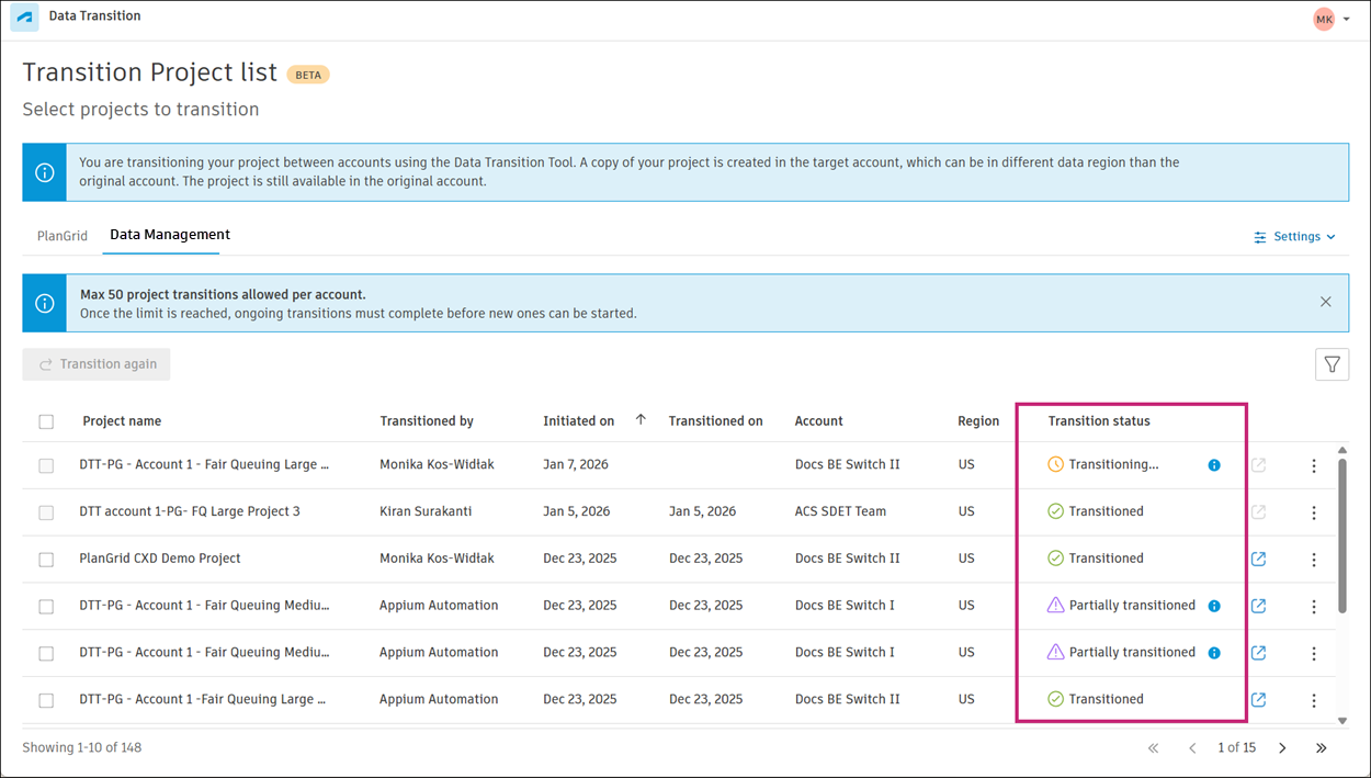

    Tip: You can review the transition status for each transitioned project on the Forma Data Management tab in Autodesk Forma.

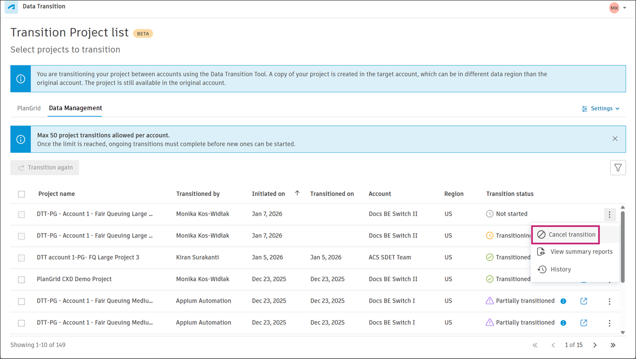

Cancelling a Data Transition
If data transition has not been started yet, you can cancel it by going to the More menu More Menu next to the project name and selecting Cancel transition.
Transition Again
If a project transition has failed or the source data has been updated, you can transition the project again. Transitioning a project again overwrites any previously transitioned data in the target hub.
  1. Click the More menu next to the project name.
  2. Select Transition again.
  3. Select the target hub from the drop-down menu, and then click Add and continue.
  4. Click Continue to start the transition.
Note: If the project was previously fully or partially transitioned to the same hub, you will see a warning message. Click Overwrite to proceed with the transition.
Also note that depending on the project size, the transition process may take some time. You can navigate away from the page while the transition is in progress. You'll receive a notification when the transition is complete.

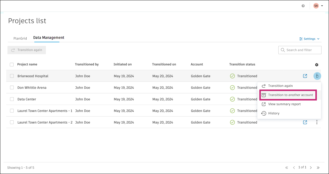

Transition Data to Another Hub
  1. Click the More menu More Menu next to the project name.
  2. Select Transition to another hub.
    More menu dialog
  3. Select the target hub from the drop-down menu.

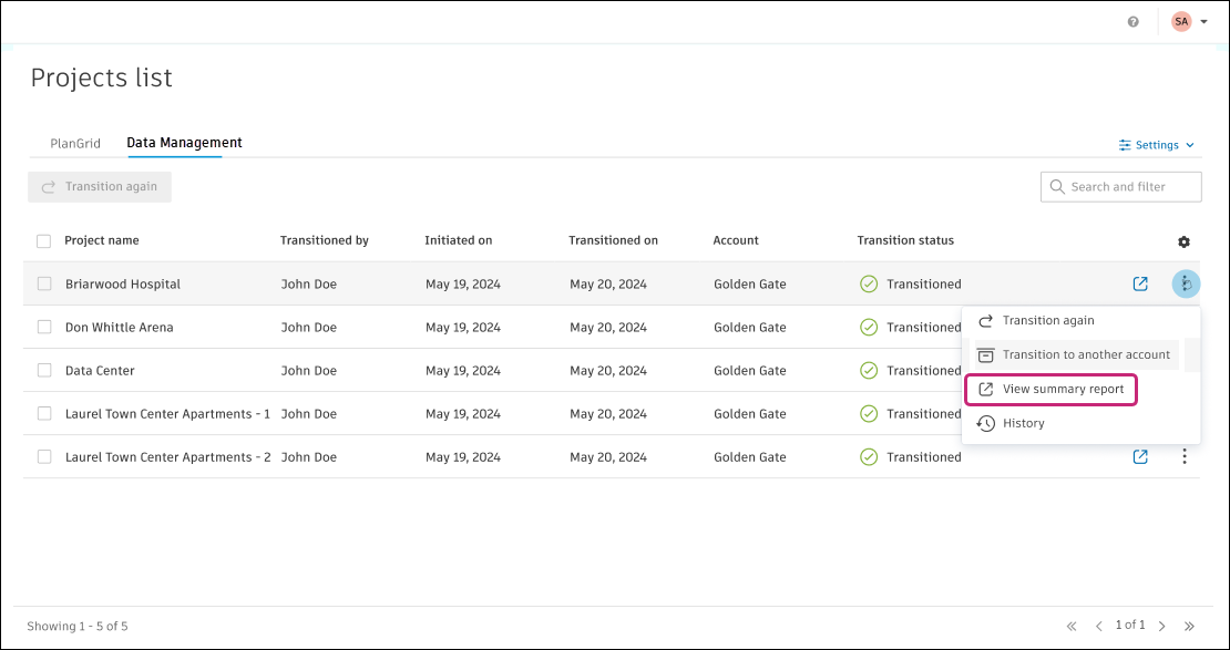

View Summary Reports
  2. Select View summary report.
    More menu dialog

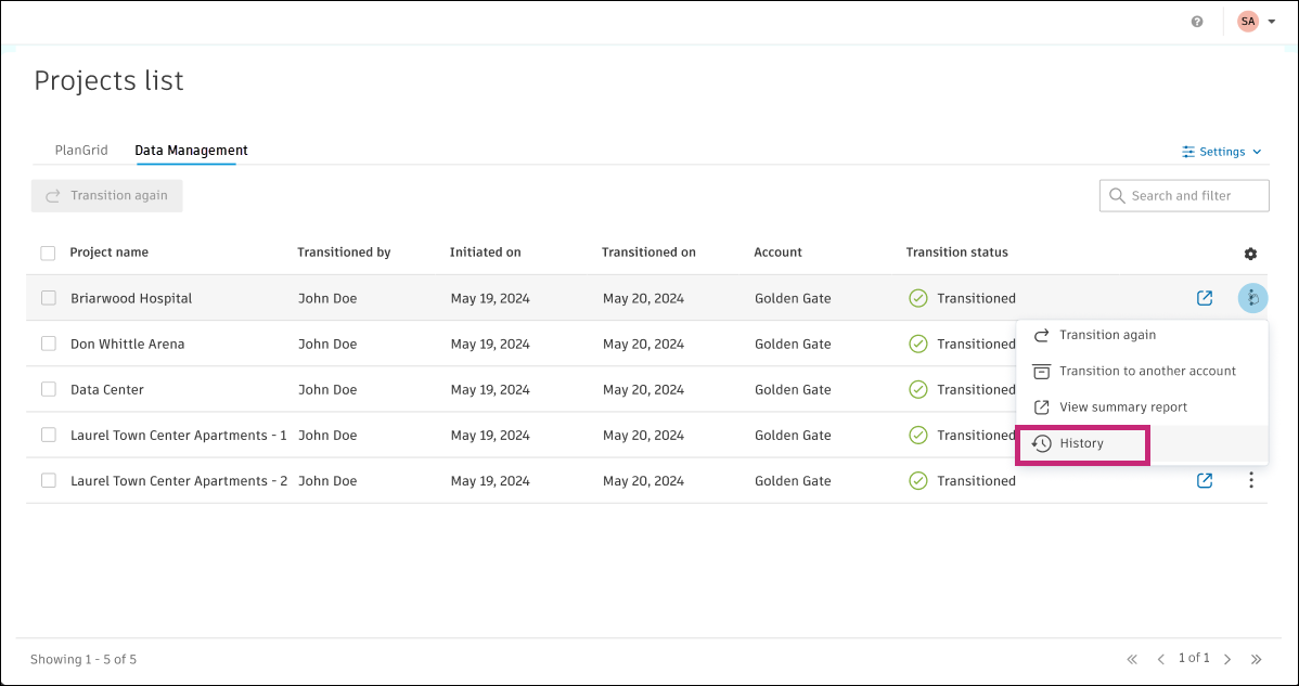

View History
  2. Select History.
    More menu dialog
    You can review the project transition history, including:
    • Date and time of each transition
    • User who initiated each transition
    • Source hub
    • Transition accuracy percentage
    • Total number of items transitioned
    • Number of items successfully transitioned
    • Number of items that failed to transition
