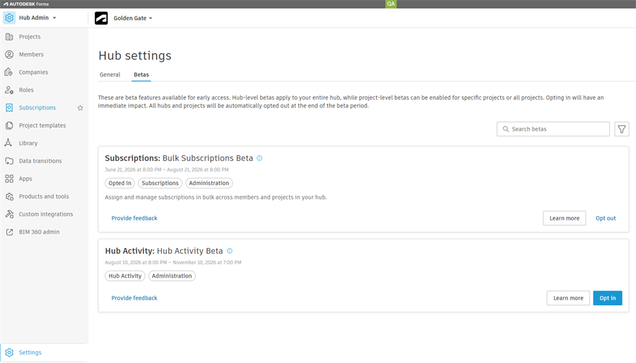

The Betas tab in hub settings lets hub administrators try new functionality before it's generally available. Each beta lists a name, an active date range, filterable tags and a description. Click Learn more for details about a specific beta's functionality.

Hub administrators can opt into a beta from the Settings page. Opting in applies to the entire hub and all of its projects.
  1. Click Opt in.
  2. Read the terms and conditions, then tick the box to accept them.
    • Some betas include a second tick box for consent to collect your hub members' data as part of the beta.
  3. Click Confirm opt-in.
The beta functionality turns on for your hub straight away. It turns off automatically when the beta ends.
