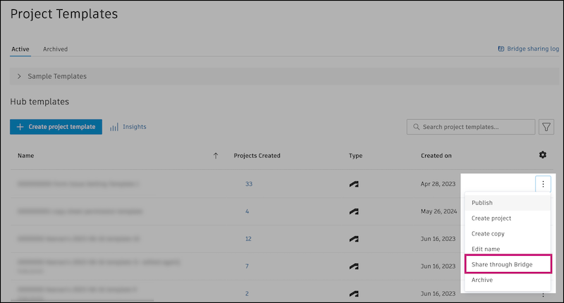

  1. Navigate to Hub Admin.
  2. Click Project templates on the left navigation.
  3. Click the More menu next to the template you want to share, then click Share through Bridge.
    Note: You can share only one active template at a time.
    Bridge is the enabling technology that lets you share project templates across hubs. You can see a log of what project templates have been shared in the Bridge sharing log. Learn more in the following section in this topic.
    Share through Bridge in More menu

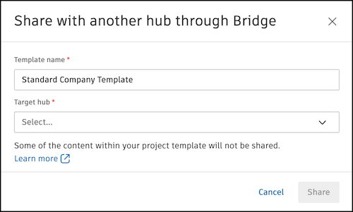

  4. In the Share with another hub through Bridge dialog, enter a name for the template in the target hub.
    Note: The template name must be unique in the target hub. It can’t match a project template or project name. The maximum length is 255 characters and can’t contain any special characters. If you reach these limits or don’t meet this criteria, you’ll see an error and will need to enter a different name.
  5. Select the target hub.
    Note:
    • You can share a template only with a hub in the same data centre. Sharing isn’t available across data centres.
    • You must be a hub administrator or standards administrator in the target hub to share a project template with that hub.
  6. Click Share.

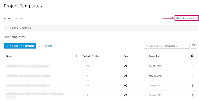

View the Bridge Sharing Log for Shared Project Templates
Track the project templates you’ve shared and received in Bridge sharing log.
  3. Click Bridge sharing log in the top-right corner.
    Bridge sharing log link
The Bridge sharing log lists each shared template’s name, status, the sending and receiving hubs, who shared it and when.
