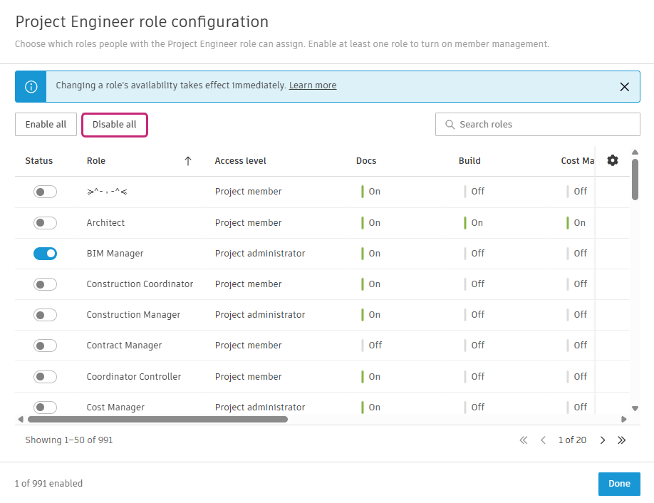

- In the role configuration modal, select the roles that members with this role can manage. Use the Enable all or Disable all button at the top left.
Important: Once you have selected one or more roles, Member management is enabled for that role. Remove all selected roles to disable Member management for that role.

- Click Configure manageable roles and then Disable all at the top left of the modal.
The Role Configuration Modal
Use the table to select which roles member managers can manage. You can:
- Search for roles by name using the search bar at the top right.
- Sort roles alphabetically by clicking a column header.
- View the access level and product access for each role.
- Change visible columns using the gear icon at the top right.
- If you have more than 50 roles, use the pager at the bottom right to move between pages.
