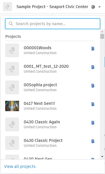

To create a project:
  1. Open the project picker and click View all projects at the bottom of the menu.
