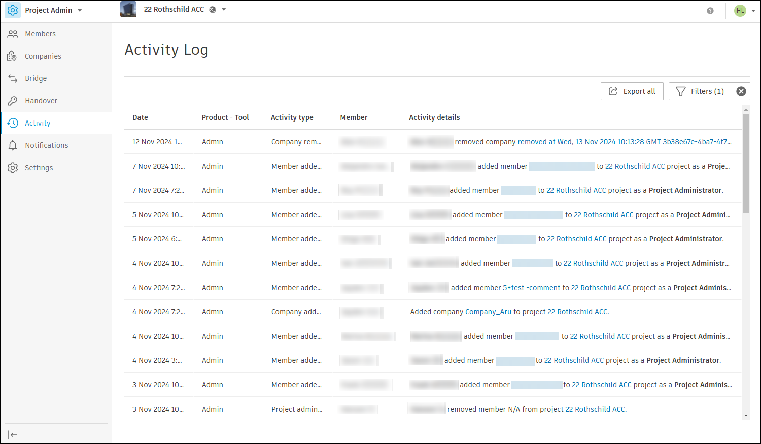

Project Activity Log
The Activity Log provides a chronological record of Admin, Forma Data Management, Issues and Sheets activities, regardless of how long these activities lasted. The tool provides project administrators with a detailed overview of who performed which activity and when. See Activities Tracked in Activity Log for a full list of tracked events.

The most recent activity is displayed on top of the log. Each activity is recorded by:

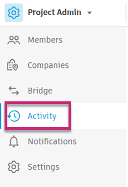

To access the Activity Log:
  1. Select Project Admin from the product picker.
  2. Click Activity.

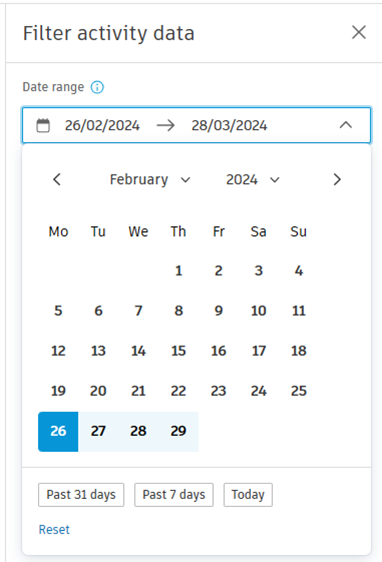

To filter by a date range:
  1. Click the Date range drop-down list to open the calendar.
    Note: The date range of 31 days is selected by default.
  2. Choose the desired start and end dates.
    Tip: Choose one of the options below the calendar to get your data sorted by one of the following time periods: Past 31 days, Past 7 days, or Today.
  3. Click Reset to remove applied filters.

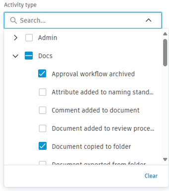

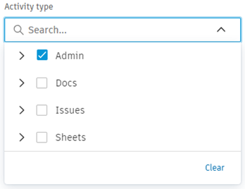

To filter by an activity type:
  1. Click the Activity type drop-down list.
  2. To filter by all activities available for any given tool, select the tick box next to this tool.
  3. To filter by specific tool activities, click the Expand icon next to the tool, and then tick the boxes next to the desired activities.
  4. To remove applied filters, click Clear.

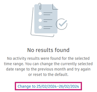

  5. If no results are found, the No results found message is displayed in the middle of the page. You can click the link below the message to change the currently-selected date range and try again.
Tip: Click below the Date range drop-down list to navigate to a previous period. For example, if your selected date range is 18/03/2024 → 22/03/2024, hitting Previous changes this range to 10/03/2024 → 17/03/2024.
