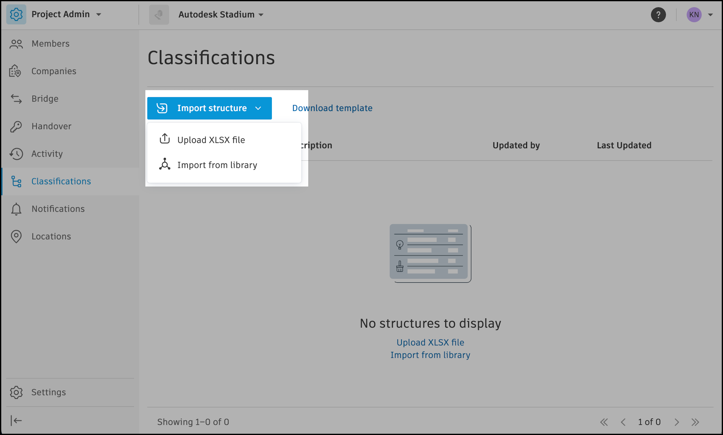

  4. Click Import structure.
    Import structure
  5. Select Import from library.
  6. Select from the classification structures that exist in the Library.
  7. Click Import.

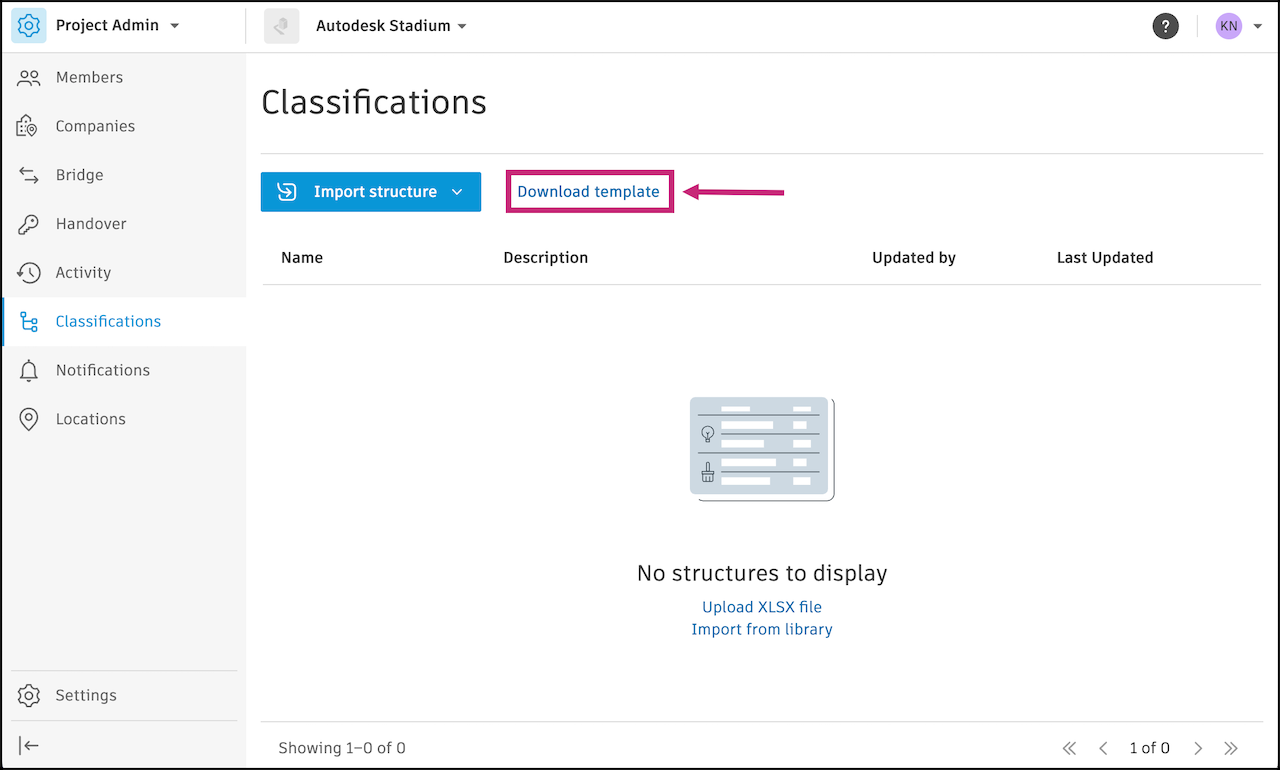

  4. Click Download template.
    Download template link
  5. Read and review the formatting guidelines in the XLSX file.
  6. Fill in the spreadsheet with your classification structure.
  7. Return to Classifications in Project Admin and click Import structure.
    Import structure
  8. Select Upload XLSX file.
  9. Drag and drop the file or select the file on your computer.
  10. Click Import.
