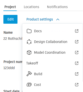

From the Settings tool, you can link to specific settings for products used on your project.
  1. From the Project tab, click the Product settings drop-down list.
  2. Select the product you want to navigate to in order to update those specific product-level settings.
Note: Only the products you have access to will appear in this list.
