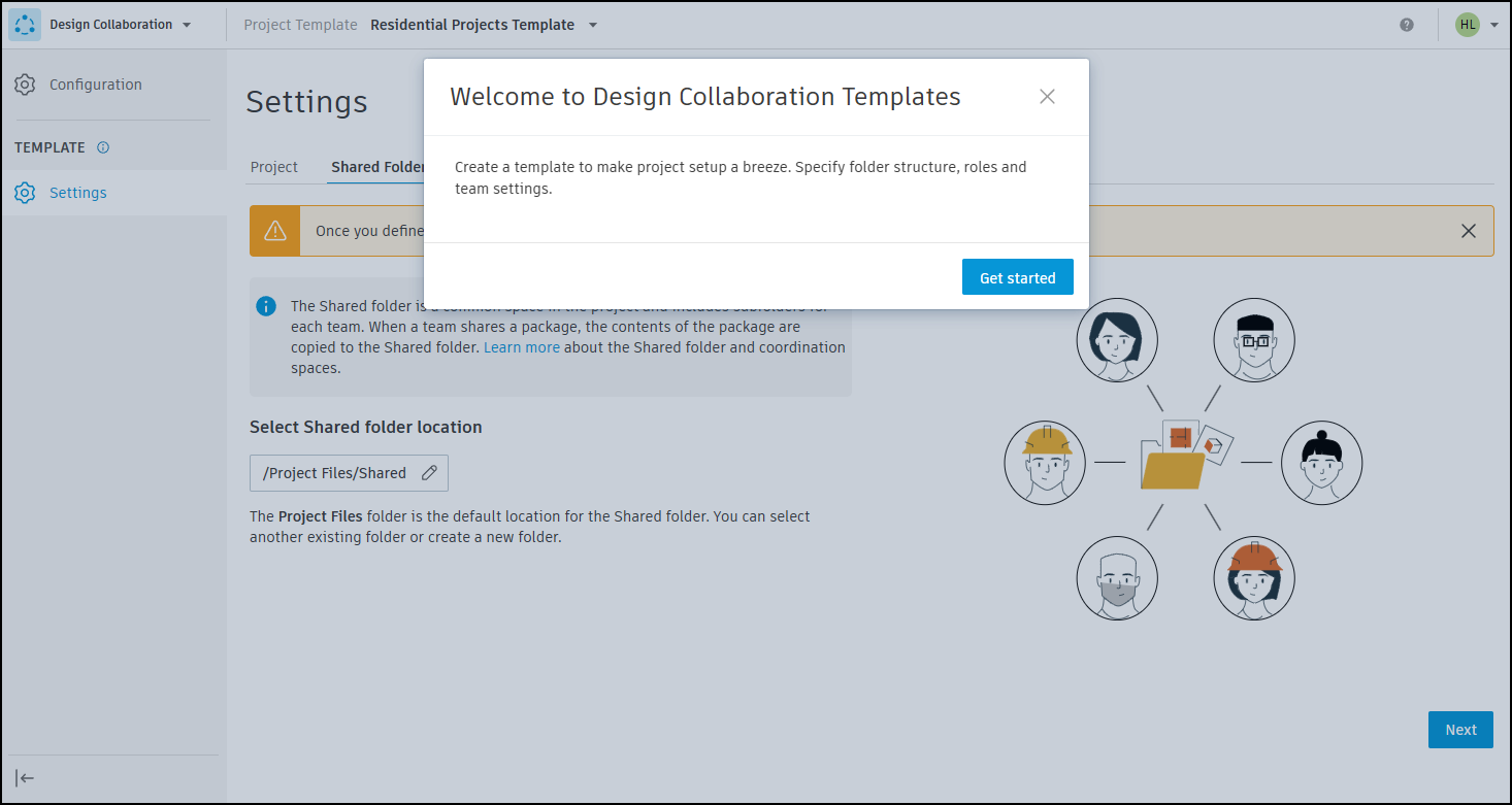

  1. In a project template, with the Design Collaboration product picked, click Settings in the left panel.
    If this is your first time, click Get started.
    Get started
  2. By default, you are taken to the Shared folder tab first. Select a location for the shared folder. You can either:
    • Use the default location, the Project Files folder.
    • Browse to select a folder in Forma Data Management.
  3. Click Next and confirm the shared folder location.
    Important:
    Once the Shared folder location has been specified for a project, it can't be changed.

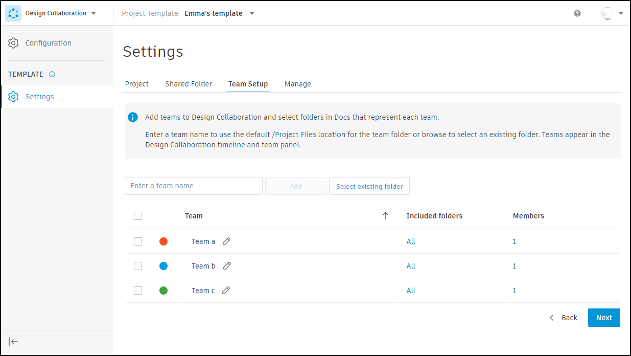

  4. Use the Team setup tab to add preconfigured teams to the template.
    1. To create teams and team folders, either:
      • Enter a team name and click Add to use the default location for the team folder (the Project Files folder).
      • Click Select existing folder, browse to select a folder in Data Management and then click ‘Add team’.
      Tip: You can also click Go to Data Management to create folders as required.
    2. Specify which subfolders within the team folders you want content to be included from in your team space. By default, all folders are included. Click All in the Included folders column and then choose from:
      • Include all folders to include data from the top-level folder and all the subfolders (default).
      • Select folders to use a folder tree to choose which folders to include data from.
      Note: Select all folders that you want to include data from. For example, selecting a parent folder will not automatically select the child folders.
    3. To add roles, companies or members to teams, click on the number shown in the Members column for the appropriate team and start typing the name in the search box. Select the relevant search result, and assign a permission level as needed.
    Note: The role, company or individual must already be a member of the hub or project template to be added to a team.
  5. Click Next.

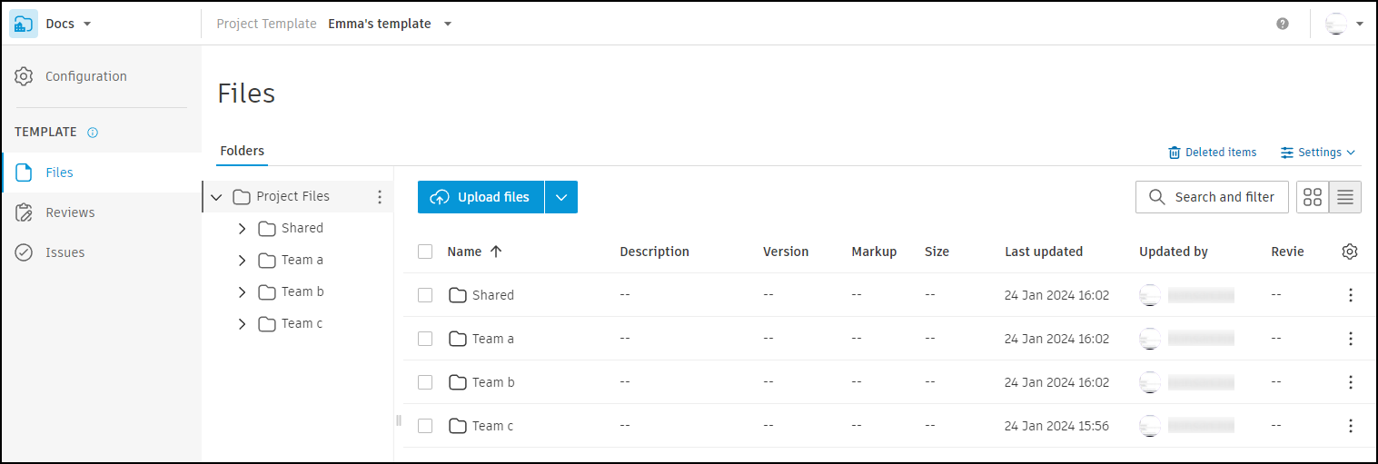

Configure Design Collaboration Folder Structures in Project Templates
In addition to configuring Design Collaboration project settings using the template, you can also set up folder structures in Data Management for use in Design Collaboration.
  1. Use the product picker to switch to Data Management.
  2. Click Files in the left panel.
  3. Create folder structures as required.
    Tip: You can also use the Reviews and Issues options in the left panel to configure more Data Management settings as part of your template. See Configure Project Templates for Forma Data Management for more information.
