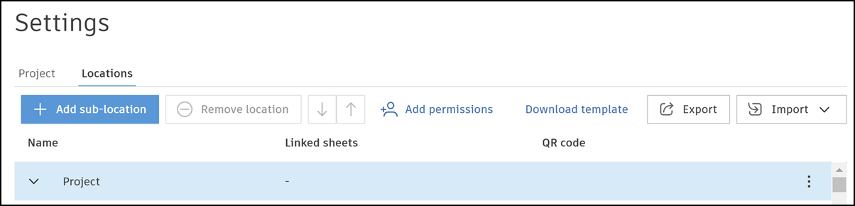

Access Locations
To access locations, in the Project Admin module, select Locations from the left navigation.
By default, the top tier is Project and this will be the only tier visible in a new project before you start adding or importing locations.

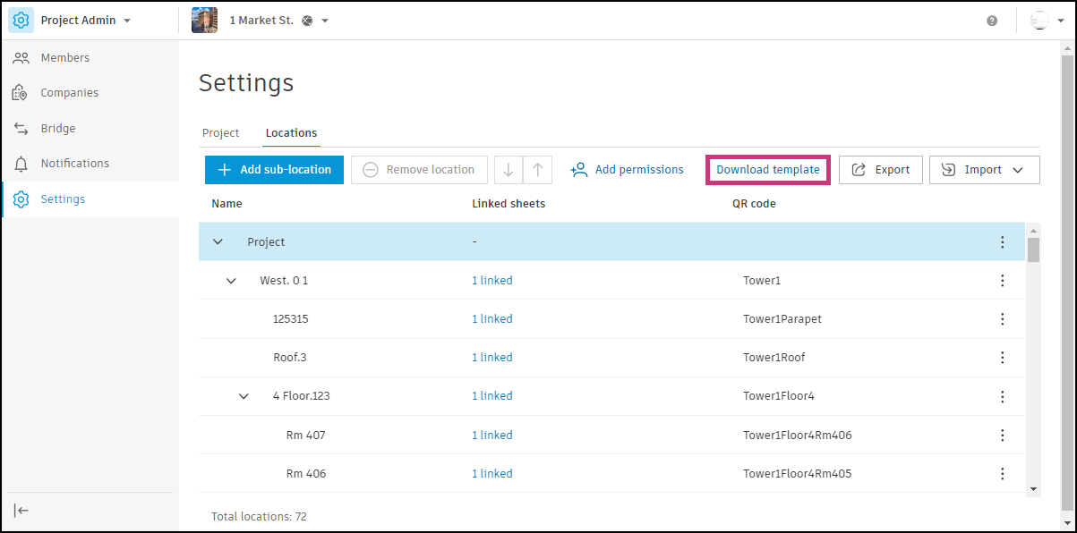

Import Locations Using a Spreadsheet Template
To import locations using a default spreadsheet template:
  1. Click Download template.
  2. Open the downloaded XLSX file from your local downloads folder.
    Read the formatting guidance provided in the second sheet onwards.
  3. Enter your location’s data in the first sheet in accordance with the guidance. See Fill In Location Import Template for detailed instructions on how to complete the template.

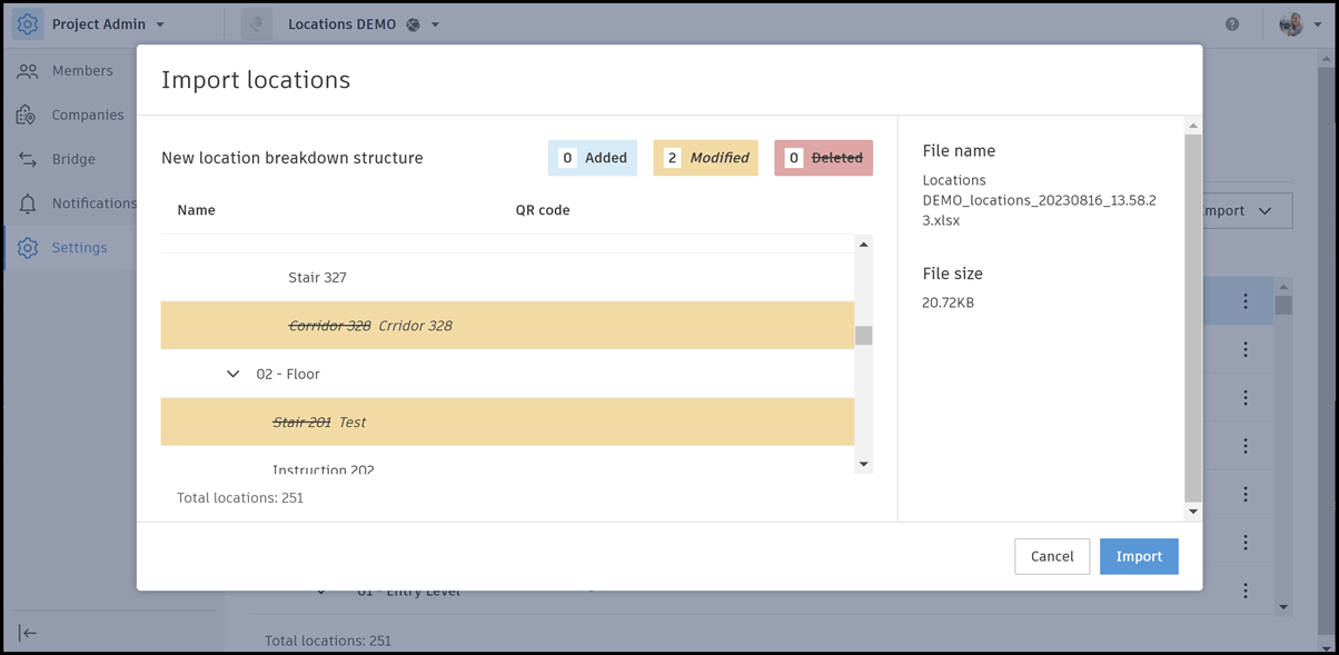

  5. Click Import and select the saved file
    Review the Import locations screen to check that the locations which have been added, modified or deleted are correct.

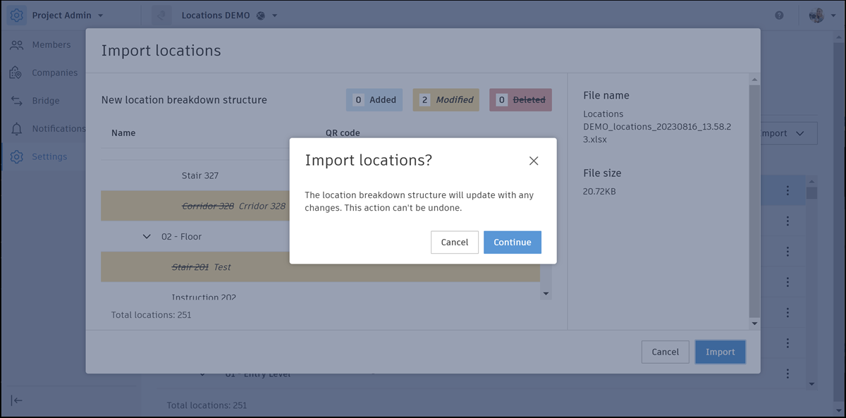

  6. Click Import.
  7. Click Continue to verify that the existing location breakdown structure will be overwritten.
    Note: An import to the root node removes existing locations and clears the locations assigned to items across the project. You can't undo this.

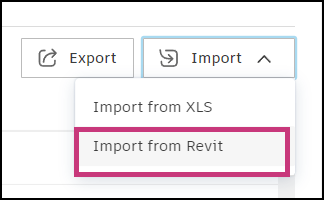

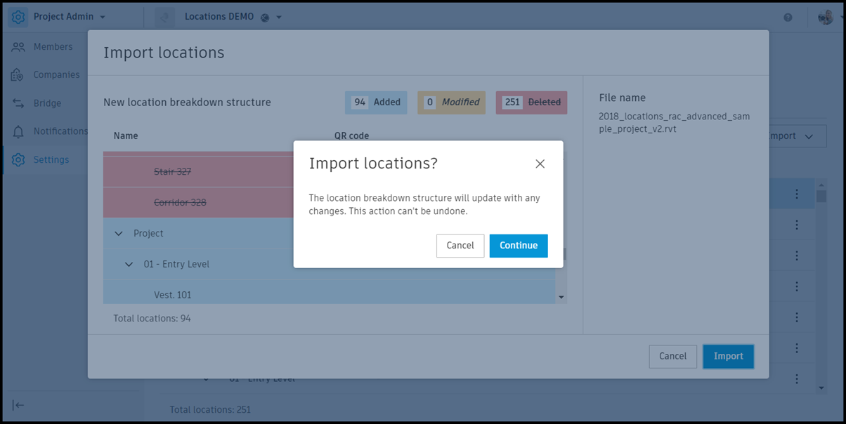

To import locations from a Revit file:
  1. Click Import > Import from Revit at the top right of the Locations page.
  2. Navigate to the Revit file that you want to upload.
  3. Click Select file.
  4. Click Import.
  5. Click Continue to verify that the existing location breakdown structure will be overwritten.

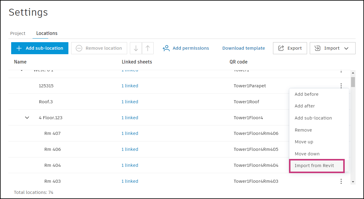

Import Locations to a Node
In addition to importing an entire location structure as described in steps 1–5 above, you can import locations only to a node. In this way, only the branch structure is overwritten, not the entire existing location breakdown.
  1. Click the More menu next to the node to which you want to import locations.
  2. Click Import from Revit.
  3. Follow steps 2-5 above.
    Locations import to node
