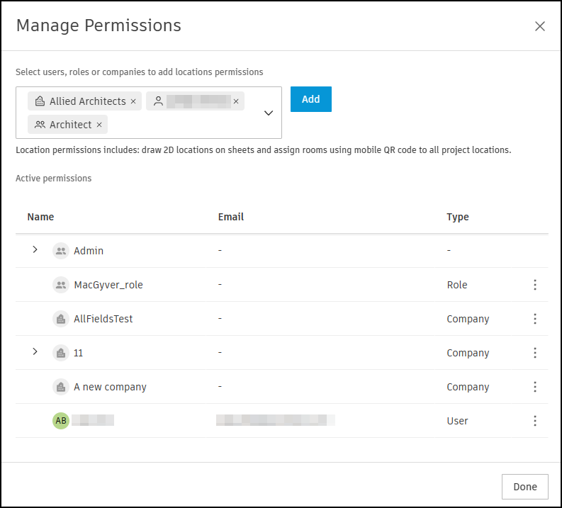

To grant location administrator permissions, project administrators need to:
  1. Click the Settings tool.
  2. Click the Locations tab.
  3. Click Add permissions.
    All users, roles and companies with location administrator permissions are listed.
  4. Add users, roles or companies.
  5. Click Add.
  6. Click Done.

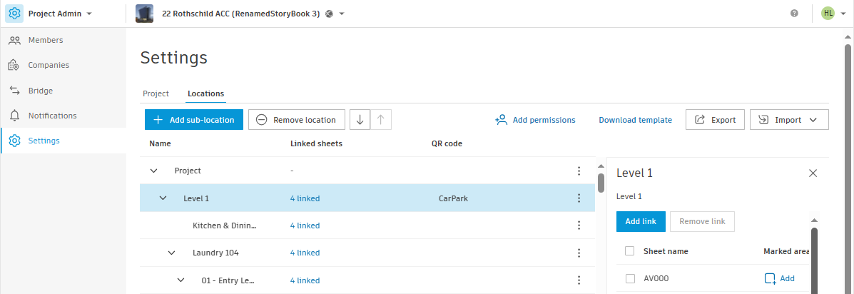

Only project administrators can link sheets to locations. Start by linking a floorplan sheet to a floor. The rooms or other sub-locations can be mapped from that document.
Note: The Sheets tool is a part of Forma Build, so only those project members who have access to Build can link sheets to locations. Members who want to work with the Sheets tool need to ask their project administrator to add them to Build. Otherwise, the Linked sheets column will not be visible to them.
  1. Click Settings
  2. Select the Locations tab
  3. Select the relevant location
  4. Click Add link in the right-hand panel.
  5. Select the relevant sheet or sheets to link to the location.
    Note: Tick the box if you want to link the sheet to the sub-locations of the location.
  6. Click Add sheet.
Note: You can tick the box next to any sheet and click Remove link to remove it from the list.

Project administrators can define the location area from the Settings tool > Locations tab by clicking Add next to the relevant sheet in the Marked area column.

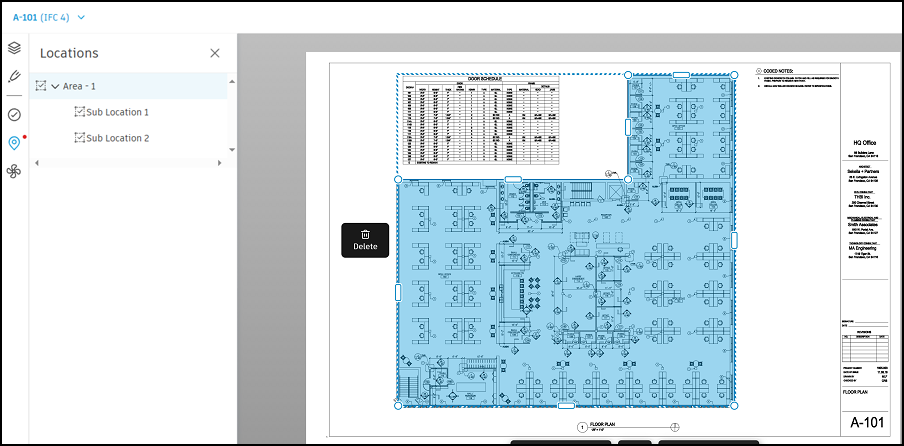

The sheet will open in Polygon/Polyline mode with the Locations panel showing.
Project administrators and location administrators can also define the location area directly on a sheet in the Sheets tool.
  1. Open the relevant sheet in the Sheets tool.

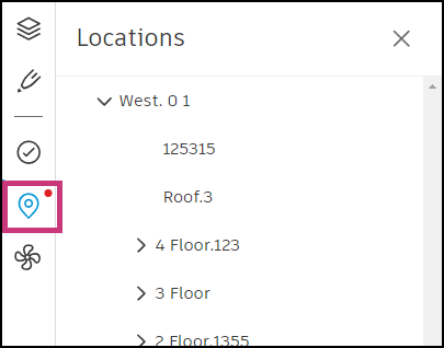

  2. Select the floor name in the Locations panel.
  3. Select the polygon tool if it's not already selected.

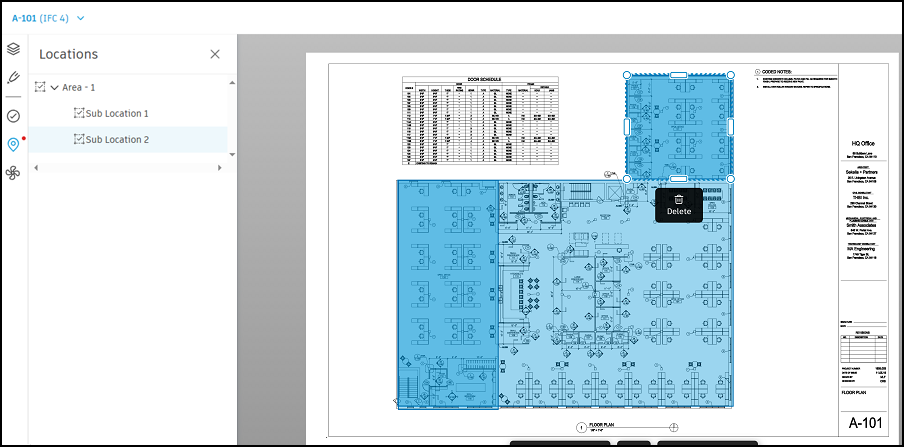

  4. Draw a shape around the floor area.
  5. Select a sub-location name and define the area with the polygon tool.
    Note: You can delete the area by clicking the Delete rubbish bin icon.
  6. Work through each location area in the sheet to ensure they have all been defined.
Changes are saved automatically after each edit.
