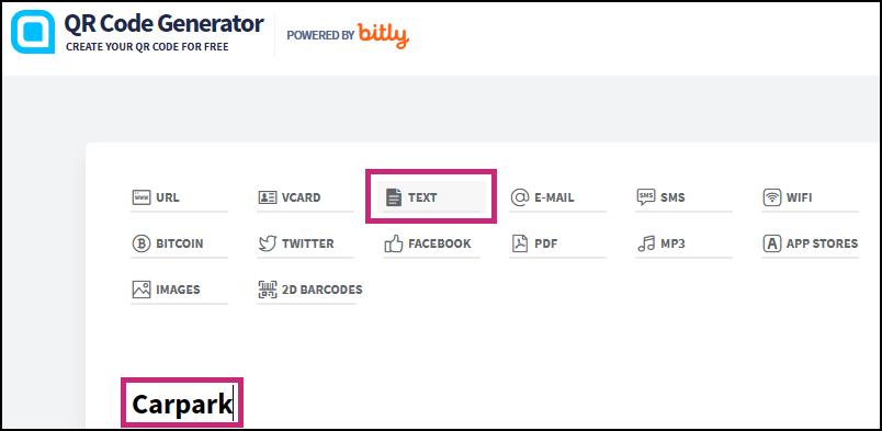

First, you need to create a QR code or barcode using an external tool. In the example below, we've used: https://www.qr-code-generator.com/
  1. Open the QR code external tool.
  2. Select TEXT.
  3. Enter the text you want to use to link the QR code to your project location. As an example, we've used the word CarPark.
Note: You will need to enter the same text for the relevant location on web. Enter a maximum of 255 alphanumeric characters with no spaces.
You can now download and print the QR code or barcode.

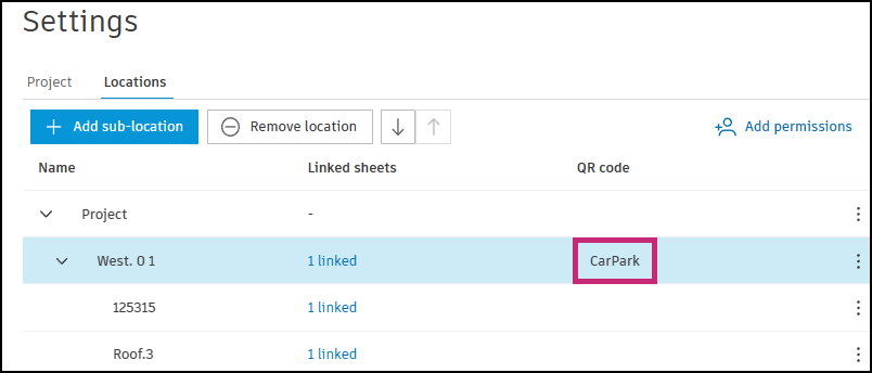

  1. Click Project Admin from the product picker.
  2. Click Settings.
  3. Select the Locations tab.
  4. Find the relevant location and click in the QR code field.
  5. Enter the same text as you entered in the QR code external tool.
Following the above example, we want to link the QR code to the location Car Park, so we'll enter the text CarPark, which we used in the QR code external tool.
