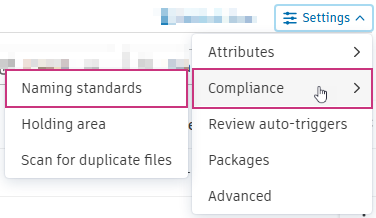

Project administrators can access, create and manage naming standards from Settings in the Files tool.
Click Files.
Click Settings.
Hover over Compliance.
Click Naming standards
If there are no naming standards created yet, you'll see a message informing you that There are no naming standards yet. If naming standards are already created, these are displayed in a table.

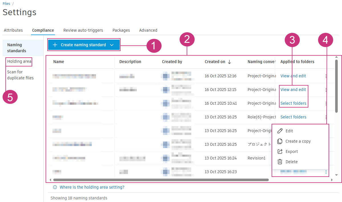

All created naming standards are listed in a table:
| Column | Description |
| Name | Name of the naming standard. |
| Description | Description for the naming standard. |
| Created by | Name of the project administrator who created the naming standard, with their company name underneath. |
| Created on | The date and time the naming standard was created. |
| Naming convention | The attributes that make up the naming convention. |
| Related attributes | The related attributes for the naming standard. |
| Applied to folders | Select and update the folders the naming standard is applied to. See below for more details. |
The Applied to folders column allows you to update the folder selection for naming standards.
Click Select folders to make your initial selection.
Click View and edit to view and update the folders the naming standard is applied to.
See Apply Naming Standard to Folders for more details.
Click on the More menu
next to a naming standard to view the following options:
| Option | Description |
| Edit | Edit the name, description, naming convention and related attributes. See Edit Naming Standards for more details. |
| Create a copy | Create a duplicate of the naming standard for further customisation. |
| Export | Export a naming standard in XLSX format ready to import to another project. See Import and Export Naming Standards for more details. |
| Delete | Delete a naming standard that isn't applied to folders containing files. The naming standard will be deleted, but the attributes associated with it will remain. |
