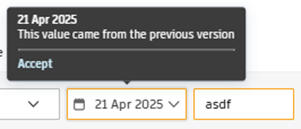

If the previous version of a file has related attribute values, these values will be displayed in the relevant related-attribute fields highlighted in yellow.
To accept a value, hover over the field highlighted in yellow and click Accept. The field will stop highlighting.
You can also bulk accept these previous version attribute values by clicking:
If you don't want to see the previous values, turn off Show attribute values from previous version at the bottom of the validator. The fields will empty and the stop highlighting.

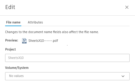

  1. Click Edit all, or select multiple files and click Edit (x).
    The edit panel will open. This is split into tabs:
    • File name: Shows all the naming convention attributes fields if a naming standard is applied.
      The Preview shows the first couple of file names in the validator. As you enter values, the preview will update to reflect the changes.
    • Attributes Shows the related attribute and required attribute fields.

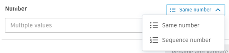

  2. Enter values for the relevant fields which you want to apply to all selected files.
    For the Number attribute and text field attributes with numeric character types select:
    • Same number to enter a number which applies to all files.
    • Sequence number to automatically number your files incrementally based on the values you enter.
    If you select Sequence number you need to enter a:
    • Start number: A positive number up to the maximum Character length of the attribute.
    • Incremental number: A number up to the maximum Character length of the attribute. This can include negative or decimal numbers. A minus symbol or decimal point counts as a character.
    If your start number and incremental number are calculated to exceed the maximum Character length of the attribute when applied, you will need to reduce the incremental number.
    When you have entered a Start number and Incremental number, you can check the preview.
