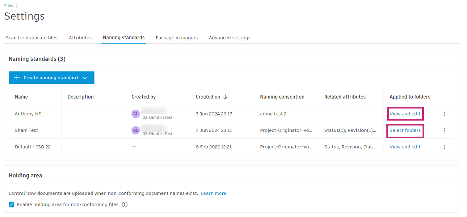

Apply Naming Standard from Settings
To apply a naming standard to empty folders:
  1. Click on the Files tool.
  2. Click Settings.
  3. Hover over Compliance.
  4. Click Naming Standards.
  5. You have the following options
    • Click Select folders if the naming standard isn't applied to any folders yet.
    • Click View and edit to update the list of folders applied with the naming standard.

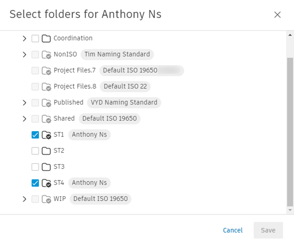

  6. Select each empty folder that you want the naming standard applied to. If the naming standard is already applied to folders, they will be selected. You can't select folders with other naming standards applied and the names of those naming standards are displayed next to the relevant folders.
    Tip: Selecting or deselecting a parent folder also selects or deselects all its subfolders
  7. Click Save.

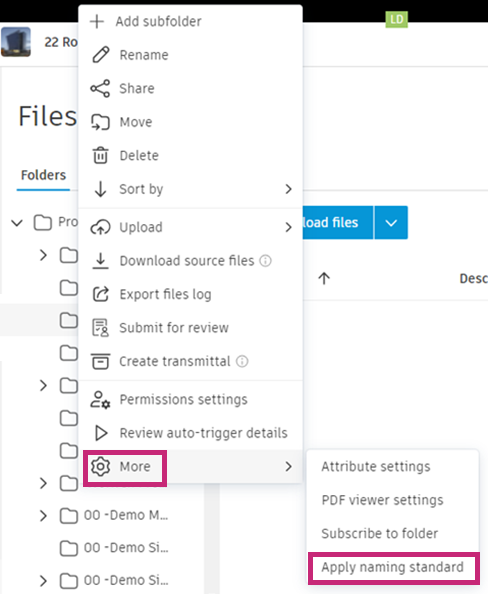

Apply Naming Standard from Folder Tree
You can also apply a naming standard to a specific folder when you are working in the main folders area.
  2. Click on the More menu of the relevant folder in the Folders tab left pane.
  3. Hover over More.
  4. Click Apply naming standard.

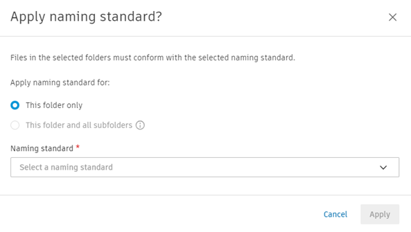

    You can apply the naming standard to:
    • This folder only
    • This folder and all subfolders: If a subfolder already has a naming standard applied, that naming standard will remain.
  5. Choose a folder option.
  6. Click on the naming standard drop-down and select the relevant naming standard.
  7. Click Apply.
