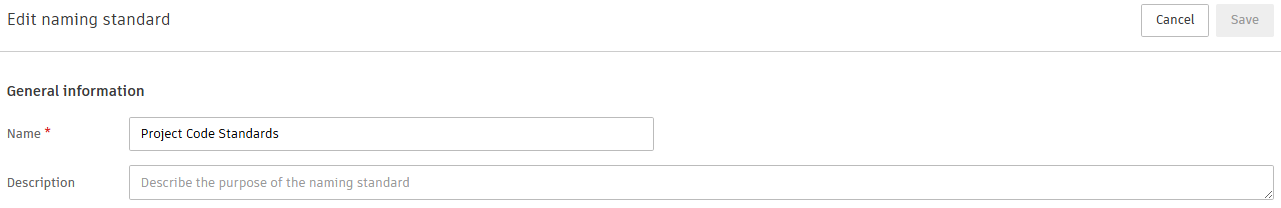

Edit General Information
In the General Information section, project administrators can edit:

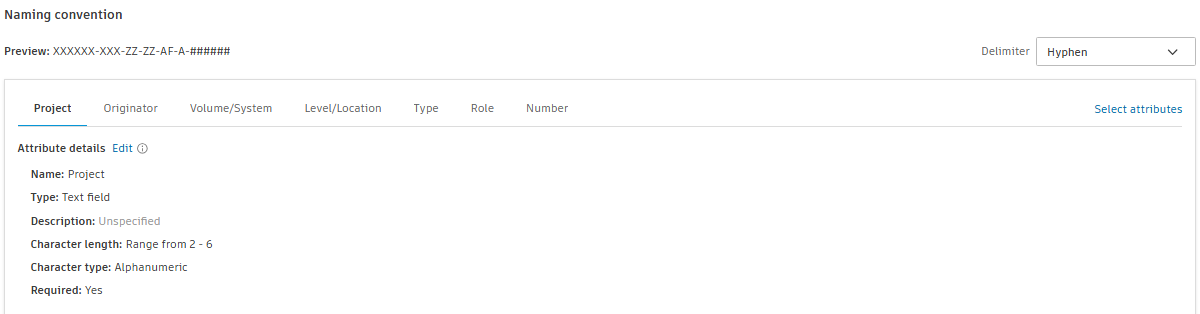

Edit Naming Convention
In the Naming convention section, you can edit attributes, add or remove attributes, reorder attributes and change the delimiter subject to the following restrictions:

Edit Naming Convention Attributes
  1. Click Edit next to the attribute details label.

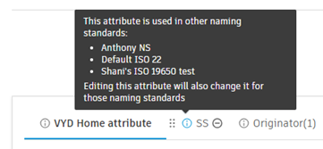

    Note: If Edit is disabled and the folders with naming standards applied don't contain files, this means that the attribute is part of other naming standards applied to folders that contain files.
    Hover over the info icon to see which naming standards also use the attribute:
    You can edit the Name and Description of all attributes in the naming convention.
    When no restrictions apply, you can also edit drop-down and text field attributes as follows:
    • Drop-down attributes: Add, edit and reorder attribute values.
    • Text field attributes: Edit the following character settings:
      • Character length: Select from Any, Fixed or Range.
        • Any: Allows members to enter a maximum of 255 characters as a value
        • Fixed: Fix the value length to be an exact number between 1 and 50 characters
        • Range: Select a value ranging from 1 to 50 characters
      • Character type: Select from Alphanumeric, Text or Numeric
        Important: If a naming convention attribute value contains the same character as the delimiter, the attribute won't be displayed correctly in the validator

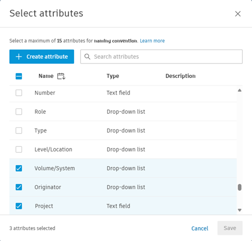

Add or Remove Naming Convention Attributes
You can remove, add and reorder attributes in the naming convention subject to the restrictions.
  1. Click Select attributes in the naming convention section.
  2. Select the desired attributes and deselect any you no longer require.
    Note: You can also hover over the tab name and click to remove the attribute.
    If the attribute doesn't exist yet, click Create attribute. See the Create Custom Attributes help section for full details about creating attributes.
  3. Click to drag and reorder the attributes as required. This will determine the order of attributes to form the file name.

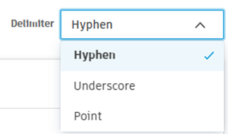

  4. Click the Delimiter menu to choose which character to use for the delimiter of the naming convention:
    • Hyphen
    • Underscore
    • Point

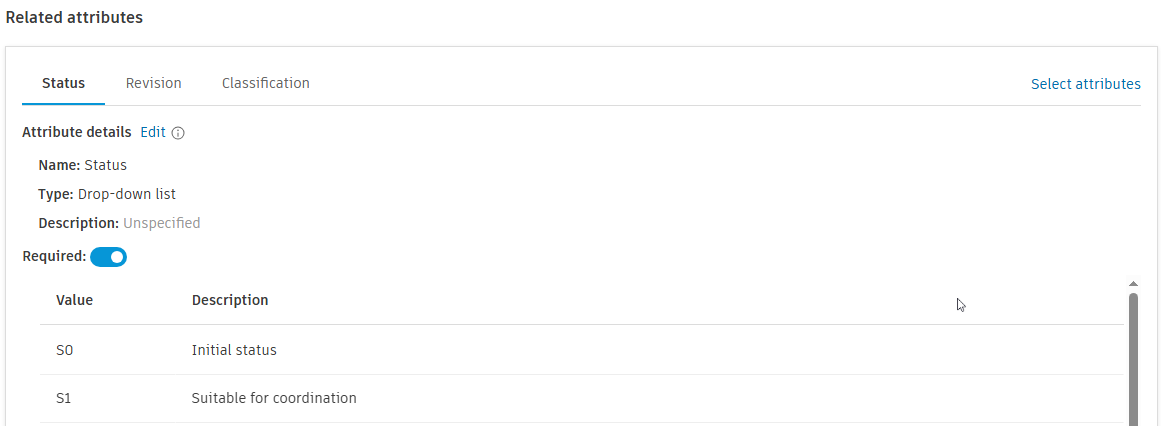

Related attributes provide information about the file's presence in the system. Attributes include:
Related attributes can be edited as long as there aren't any files in folders applied with a naming standard that use those attributes. You can edit details like the name and description and also details specific to the attributes, such as the:
To change the attribute details, select the tab of the relevant attribute and click Edit next to the attribute details label.
You can also set related attributes as Required if necessary. This means that when files are added to folders with a naming standard applied, they will need a compliant attribute value before the file is displayed in the folder.
Related attributes can also be added, removed or reordered in the naming standard. However, if related attributes are set as required, they can't be added or removed from a naming standard if it's applied to folders that contain files.
Note: You can select a maximum of 30 attributes for related attributes.
