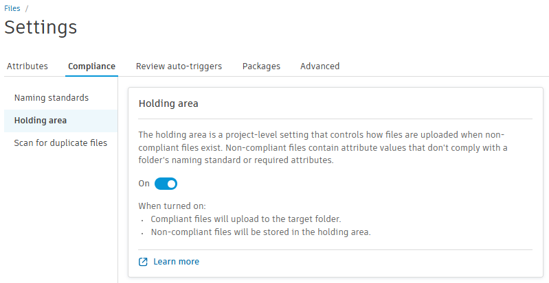

The holding area setting is a project-level setting that controls how files are uploaded when non-compliant files exist in the selection. Non-compliant files are files that contain attribute values that don't comply with a folder's naming standard or required attributes.
Uploaded files are first checked in the file validator for compliance.
If the holding area setting is turned on, members can choose not to correct any non-compliant attribute values and continue. Compliant files will be uploaded to the target folder, and non-compliant files will be stored in the holding area. The attribute values can be edited later so the files are displayed in the relevant folder.
If the holding area setting is turned off, all selected files need to be compliant to be uploaded to the target folder. Non-compliant files won't be uploaded to the target folder or be stored in the holding area.
The holding area will automatically be turned on for the first time if any of the following occur:
Project administrators can manually turn the holding area setting on or off.

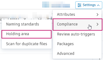

Click on the Files tool.
Click the Settings drop-down.
Hover over Compliance.
Click Holding area.
This opens the holding area setting.
Click the toggle to turn the holding area on or off as required.
If you turn the holding area off, any previously uploaded non-compliant files will remain in the holding area.

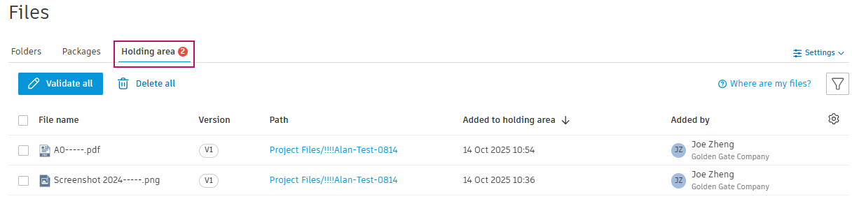

When the holding area is turned on, all project members can access it as follows:
Click the Files tool.
Select the Holding Area tab.
All non-compliant files are sorted by default from the most recently added to the holding area. The holding area details:
| Detail | Description |
| File name | The name of the file stored in the holding area. |
| Version | The version number of the file. |
| Path | The folder path where the file will appear once renamed correctly. |
| Added to holding area | The date and time the file was placed in the holding area. |
| Added by | The member who uploaded the non-compliant file. |
| Compliance errors | Information about whether the file doesn't comply with required attributes or an applied naming standard. |
| Related attributes | Attributes linked to naming standards, such as Status, Revision and Classification. |

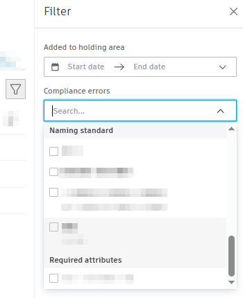

You can refine the number of files listed in the holding area by using filters.
Click the filter icon.
You can:
Select a date range to only show files added to the holding area during those dates.
Select specific naming standards or required attributes to only show files with those errors.
Make your selections and click Apply.
