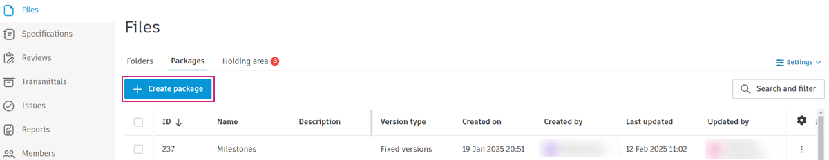

Project administrators and package managers can create packages:
  1. Click on the Files tool.
  2. Click on the Packages tab.

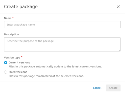

  3. Click Create package.
    This opens the Create package dialog.
    • Name: Enter a name for the package.
    • Description: Enter a description of the package as necessary.
    • Version type:
      • Current versions: Select this option if you want all the files in the package to update to their current versions.
      • Fixed versions: Select this option if you want all the files in the package to remain fixed at their selected versions.
  4. Click Create.

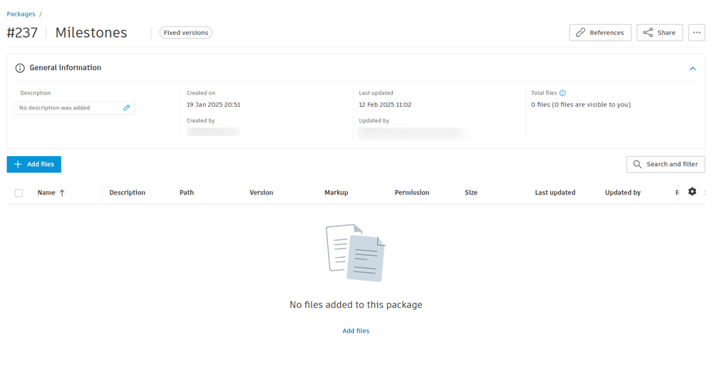

    Your package will be displayed in the packages list with an automatically added ID number.

  1. Click the relevant package from the packages list to open it.
  2. Click Add files.

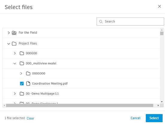

  3. Select files from the file picker. You can also search for files if necessary.
  4. Click Select.

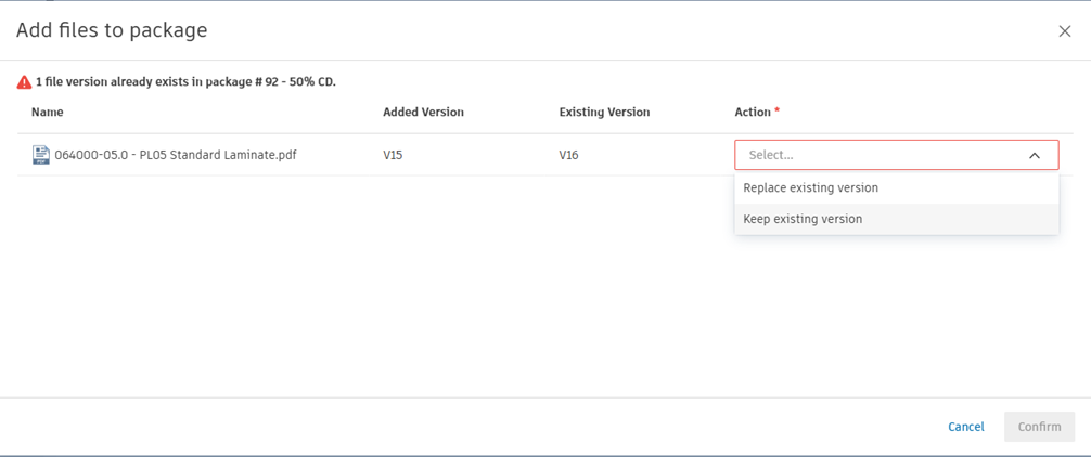

    This opens the Add files to package dialog. There is a different workflow depending on whether you are adding files to a Current version or Fixed version package:

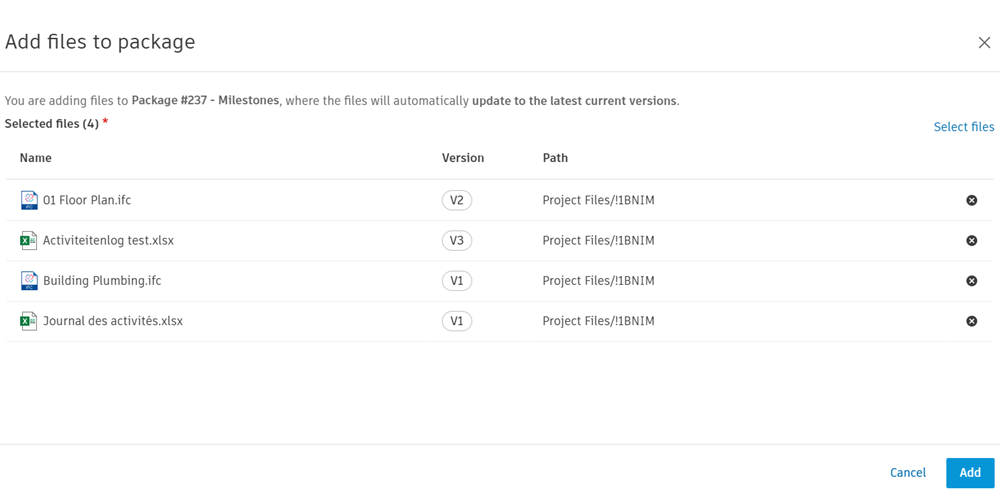

    Current version package
    The files you've selected will be displayed with the current version number at the time of selection. You can't change the file version you are adding as a current version package always shows the latest current version of each file.

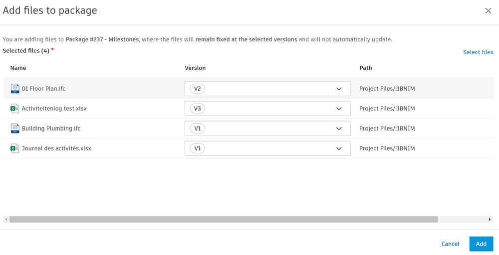

    The files you've selected will initially be displayed with the current version number at the time of selection. Click a drop-down in the version field to switch to a different file version. This fixes the version to the package, which means that the file won't automatically update in the package when a new version is added to the Files tool. You can change the version of a file in a fixed version package again later.
    Note: If you've selected a different version of a file which already exists in the fixed version package, you need to select which version you're keeping.
  5. Click Select files if you want to add more files to the package.
  6. Click Add when you've finished.

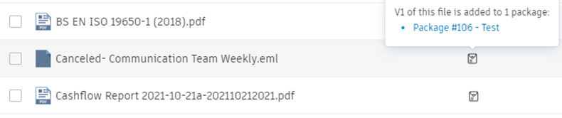

    The files will be displayed in the package. If you view the file from the folder tree instead, an icon will be displayed in the Indicators attribute to show that the file has been added to a package.
    Hover over the icon for details about which package the file is added to and to access a link that opens the package.
