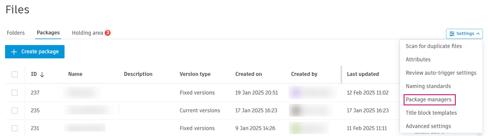

Access Package Manager Settings
A project administrator needs to:
  1. Click on the Files tool.
  2. Click on the Packages tab.
  3. Click Settings.
  4. Click Package managers.

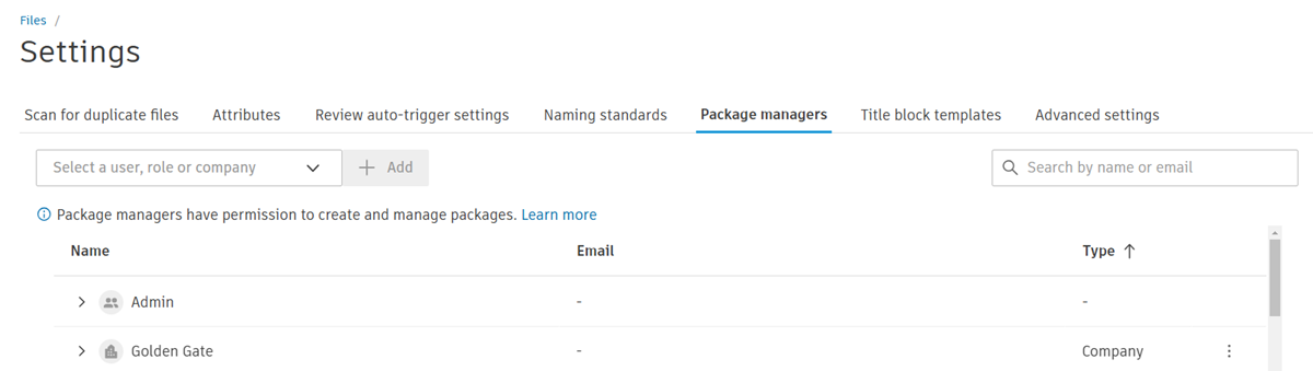

    This opens the Package managers page, where you can view, search and add users, roles and companies as package managers.
Add a Package Manager
To add a package manager:
  1. Click on the Select a user, role or company field.
  2. Start typing the relevant name to bring up suggestions.
  3. Select the relevant entries.
  4. Click Add.
    Your selection will display in the package managers list.
    Note: Project administrators are automatically included in the collapsible Admin section.
    You can also search by name or email address.

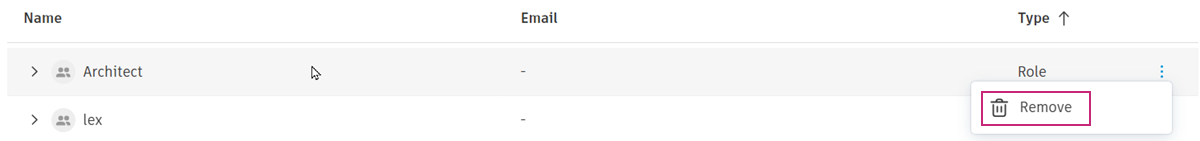

Remove a Package Manager
  1. Click on the More menu of the relevant user, role or company.
  2. Click Remove.
    You'll see a message informing you that the relevant user, role or company granted permission will be removed. However, sometimes, a member may have been granted package manager permission in different ways. For example, a member may be granted permission as an individual and also as part of a role or company. If they have their user permission removed, they will still have package manager permission based the role and company.
  3. Click Remove.
