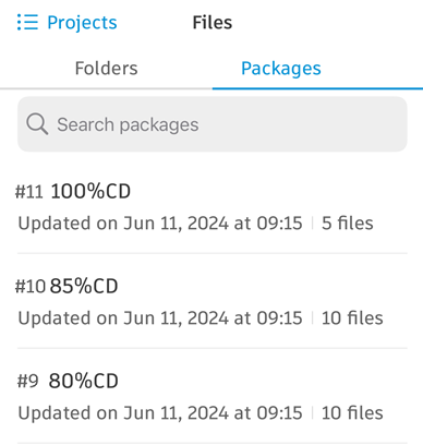

The Packages tab is located next to the Folders tab in the Files tool on mobile.
Tap the Packages tab to display a list of all available packages. You can search for packages by name.

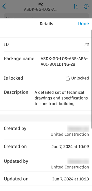

Tap the information icon to view package details.
The package details information includes:

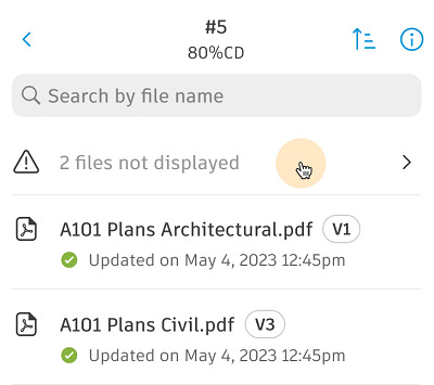

Tap a file in a package to download and view the file. Downloaded files have a green tick icon.

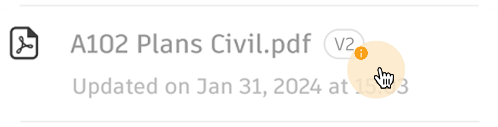

You can only download the current versions of files. This means that if a previous version is added to a package, you can't download and view the file. An orange icon on the version number indicates that the file version added to the package is not the current version and, therefore, can't be downloaded.
If you don't have permission to view some files in the package, or the files are deleted, this information is displayed at the top of the package file list.
