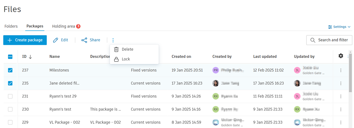

The Packages tab in the Files tool lists all created packages along with details including the assigned package ID, the package version type and total files in the package.
You can search and filter these packages to refine the packages list.

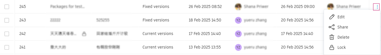

You can edit, share, delete and lock one or more selected packages. For a single package, click the More menu to access these options.
If you select multiple packages, either click Edit above the packages list or click the More menu for Delete and Lock options.

  1. Select one or more packages.
  2. Click Delete.

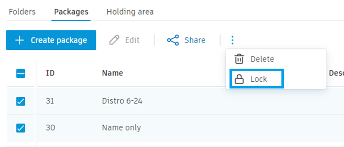

  1. Select one or more unlocked packages.
  2. Click on the More menu above the package list.
  3. Click Lock.
    Note: The Lock button is disabled if you select over 1,000 packages.
  4. Click Lock when the message displays.

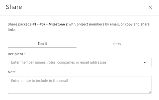

  1. Select the packages that you want to share.
  2. Click Share.
    You can share the selected packages with project members by email or copy and share links.
    • Email: Click Recipients and select members, roles or companies and click Save. Enter a note if necessary. Click Send.
    • Links: Copy all or selected links and share them as necessary.
    When the recipient accesses the copied link or link in the email, they will be redirected to the relevant package in the Packages tab in the Files tool.

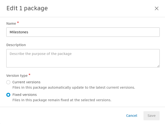

Edit Packages
Project administrators can edit the Name, Description and package Version type of any unlocked package. Package managers can only edit a package that they've created and that is unlocked.
  1. Click Edit.
    The details you can edit depend on whether you've selected a single package or multiple packages.
    Single package
    You can edit the Name, Description and package Version type as required.
    Note: You can also open a single package from the list to edit its name and change the package version type from the package.
    Multiple packages
    You can only edit the package Version type.
    See Change Package Version Type for more details on changing version types.
  2. Click Save.
You can change the version type of a package after it's been created.
If you change a current version package to a fixed version package, the existing files will stay fixed at those current versions. Specific file versions need to be selected for files added after this change. Files will not automatically update to the latest current versions. You can manually update file versions later if necessary.
If you change a fixed version package to a current version package, the files will automatically update to their current versions.

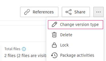

There are two ways to change the package version type:
  1. Edit a package to change the package version type. See Edit Packages for details.
  2. Open a package > click the More menu > click Change version type.

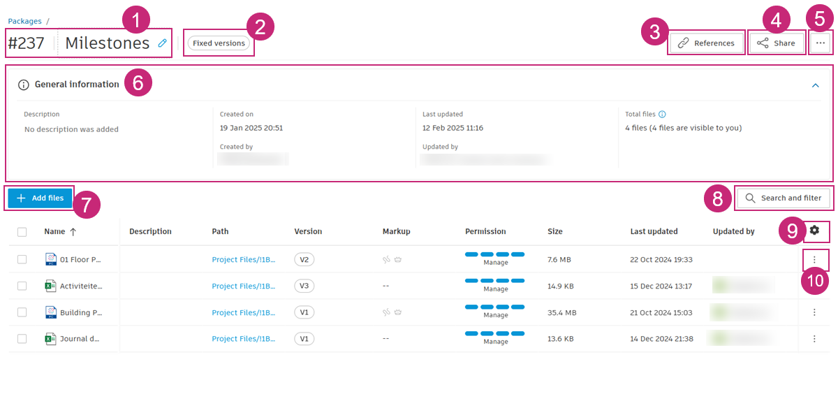

When you click a package in the packages list, the package will open and display any added files, details about the package and many options including the options available from the packages list.
The following numbers correspond to the numbers in the preceding image:
  1. Package ID and name: Each package is assigned a unique ID. You can click the package name to edit it.
  2. Package version type: This will appear either as Fixed versions or Current version as relevant.
  3. References: This displays any items which have added this package as a reference.
  4. Share: Click to share the package with other project members. See Share Packages for more details.
  5. Package More menu: Click to view the following options:
    • Change version type: This will change the package version type, for example from a fixed version package to a current version package.
    • Delete: This deletes the package, and the package files will no longer be associated with the package.
    • Lock or Unlock: This locks or unlocks the package. See the Lock and Unlock Packages section below for more details.
    • Package activities: This lists the activities for this package.
  6. General information: This contains summary information including Total files. A package may contain more files than you can actually view. This is due to members requiring View folder permission or above for each file in the package. Total files details the actual number of files in a package and the number of files visible to you.
  7. Add files: Click to add more files to the package.
  8. Search and filter: Click to search for specific files in the package. See Search and Filter Packages for more information.
  9. Attributes: Click to reorder, show and hide attributes, and access attributes settings. See the Package File Attributes section of the help
  10. File More menu: See Manage and Consume Files in Packages for more information.
