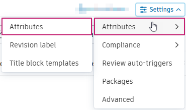

Project-level custom attribute creation access
Project administrators can access project-level settings:
  1. Click on the Files tool.
  2. Click Settings.
  3. Hover over Attributes.
  4. Click Attributes.

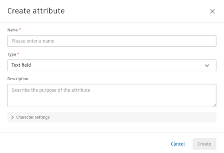

  1. Click Create attribute.
  2. Complete the required Name and Type fields. For Type, you can select from either text field, date, drop-down list or large drop-down list as detailed below.
  3. You can also enter a Description.
The following sections detail how to create the different attribute types after you've selected one from the Type field.

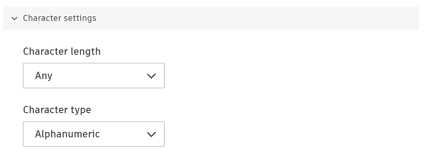

Text field attributes
Text field attributes let members enter a value in a text field. You can add the following Character length and Character type constraints:

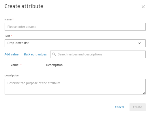

Drop-down list attributes let members choose from a defined list of values. You can add a maximum of 400 values of 32 characters each. The name of each value must be unique.
Click:
  1. To add your new values, ensure that there are no duplicated or blank value cells before clicking Done.

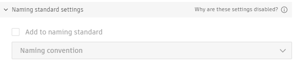

    Project administrators can also add the attribute to the naming standard (either the naming convention or related attributes) if the naming standard enforced isn't applied to folders that contain files.
  2. Click Create.

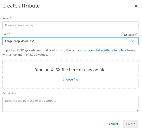

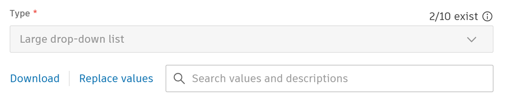

Large drop-down list attributes work like drop-down list attributes, but support up to 2,000 values instead of 400. You can create a maximum of 10 large drop-down list attributes per project.
Important: Large drop-down list attributes are only supported in v2027.2 of Desktop Connector or later. See the Desktop Connector Latest Release and Notes to install the latest supported version.
Large drop-down lists are created by downloading an XLSX template and entering values and descriptions.
  1. Click Large drop-down list attribute template in the Create attribute dialog.
    The Large drop-down list attribute template will download to your local downloads folder.
  2. Open the template.
    The Large drop-down list attribute template has 3 tabs:
    • INSTRUCTIONS: This details how you can add values and descriptions, including requirements and limitations. Read these instructions before
    • EXAMPLE: This is an example set of values and descriptions which adhere to the requirements and limitations.
    • TEMPLATE: This is where you enter your values and descriptions.
  3. Enter the values and their descriptions in the TEMPLATE tab.
    • You can enter a maximum of 32 characters for each Value field and a maximum of 255 characters for each Description field.
    • Only the Value and Description field values will be imported
    • Rows are inserted in the order they appear in the spreadsheet.
  4. Save your changes.

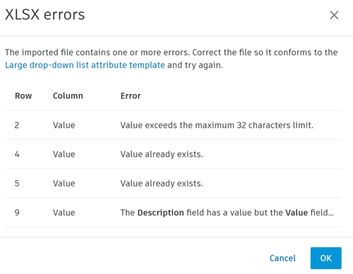

  5. Drag the saved file into the dropzone in the Create attribute dialog. You can always upload the file as necessary.
    The system checks whether your entries have any errors. For example, duplicate values, values which exceed the character limit, values entered for one column but not the other.
    If there are any errors, fix and save these in your file before dragging them into the dropzone again.
  6. Click Create.

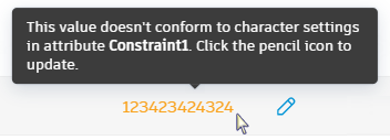

    Note: Changes to text field attribute character settings do not automatically update existing file attribute values. Noncompliant values are highlighted in yellow in the Files list and must be manually edited to comply with new constraints.

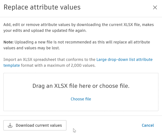

Edit large drop-down list attributes
You can edit the name and description of a large drop-down attribute directly from the Edit attribute dialog. However, the values and their descriptions are edited by downloading the existing values in an XLSX file, editing and saving the file, then uploading again.
Important:
  1. Click Replace values in the Edit attribute dialog.
  2. Click Download current values. This downloads an XLSX file of the attribute values to your local downloads folder.
  3. Open the downloaded file and add, edit or remove attribute values and their descriptions as necessary. Your changes are subject to the restrictions in the previous table.
  5. Drag or upload your saved file into the dropzone in the Replace attribute values dialog.
  6. The values and their description will now be displayed.
  7. Click Save.

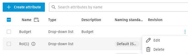

Delete Custom Attributes

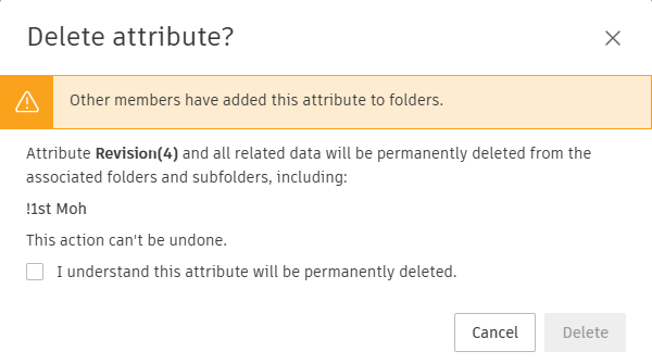

Project administrators can delete custom attributes. Members with Edit permission or above can only delete attributes they've added themselves.
You can delete custom attributes subject to the following exceptions. Attributes can't be deleted if they are used in:
For example:
  1. Click Delete.
    The dialog warns you that the attribute and all related data will be permanently deleted from the associated folders and subfolders.
  2. Click I understand this attribute will be permanently deleted.
  3. Click Delete.
