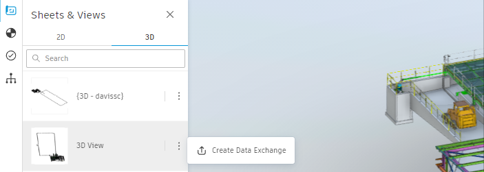

  1. Click the Files tool.
  2. Click the relevant Revit file to open the viewer.
  3. Select the Content icon
  4. Select the 3D tab.
  5. Select the desired 3D Revit view.
  6. Click the More menu
  7. Click Create Data Exchange.
    Important: You can only create a Data Exchange from models published from Revit 2023 or later. A warning will be displayed if the model is from an earlier version of Revit and you won't be able to create the Data Exchange.

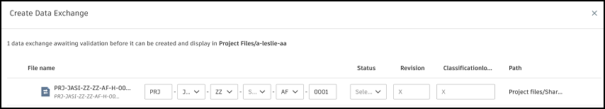

    Folders with naming standard or required attributes applied
If the selected folder is enforced by the naming standard or has required attributes applied, the name of the Data Exchange will have to be validated.
  1. Click Continue.
    The file validator will open.
  2. An error will be flagged for the non-compliant attribute values. You choose between two options:
    • Edit the file name attributes to comply with the naming standard or required attributes as relevant
    • If the Holding Area is turned on, you can choose not to correct the attribute values and continue creating the Data Exchange.
  3. Create the Data Exchange.
    If you have edited the attribute values so they now comply, the Data Exchange will be displayed in the selected folder.
    If you have not corrected the attribute values, the Data Exchange won't be displayed in the selected folder until its attribute values are corrected in the Holding Area.

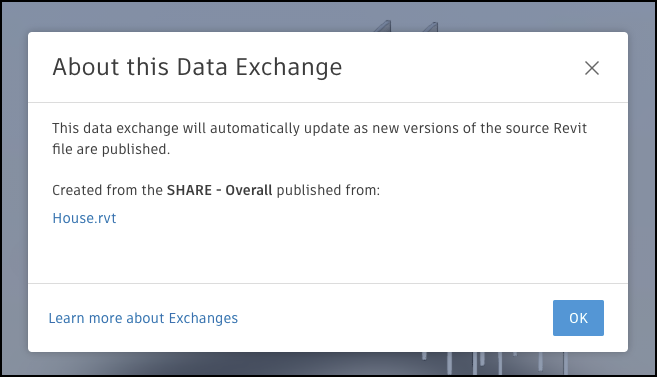

You can learn more about the Data Exchange source file, last updated by and when it was last updated, by clicking in the viewer.
If the information icon is red , the Data Exchange may be out of date as it can't update automatically. See the Frequently Asked Questions help topic for potential causes and suggested solutions.
The Data Exchange version’s up when the updated source Revit file is:
Important: If you use the Save As > Cloud Model option in Revit, this won't update the Data Exchange.
