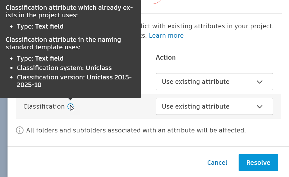

When you create or import a naming standard and there are conflicts, the Resolve attribute conflicts dialog opens. Any naming convention or related attribute conflicts are highlighted in red.
The conflicted attributes are listed below. You can hover the info icon to view the attribute details of the conflicting attribute in the naming standard compared with the same attribute which exists in the project.
This may help you to work out which option to use to resolve the conflicts. You can resolve these conflicts by clicking the drop-down for each listed attribute. You have the following options which will be displayed according to the attribute error:
Use existing attribute: Use the attribute which already exists in the project instead of the conflicting attribute in the new naming standard.
Overwrite existing attribute: Overwrite the existing attribute with the details and values of the new naming standard attribute.
Create and use new attribute: Create a new attribute by copying the new naming standard attribute and giving it a modified name.
Merge existing and template attribute: Add the values from the new naming standard attribute to the existing attribute.
