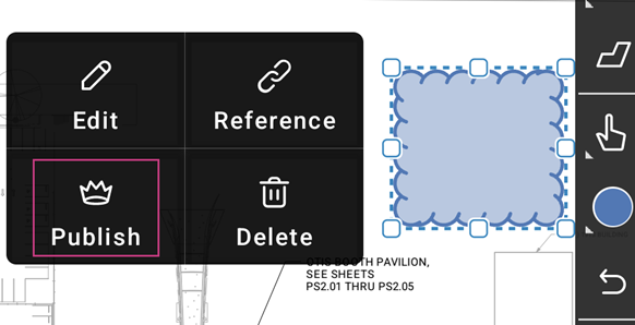

Publish and Unpublish Markups on Mobile
An unpublished mark-up is only visible to the member who created it. Markups are unpublished by default, and members with the relevant permissions must publish these to make them visible to the entire project.
Published markups are visible to all members. Only members with Create permissions or higher can publish markups. See Mark-up Permissions for more information.
To publish a mark-up:
  1. Tap a markup.
  2. Tap in the menu above the markup.
Markups you create on PDF files on mobile will sync to the web.

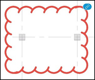

Add references to mark-ups on Mobile
In the Autodesk Forma mobile app, you can add references to other sheets, files, RFIs, forms, submittals and assets on a markup.
  1. Create a markup or tap on an existing markup.
  2. Tap in the menu that appears.
  3. Tap Add next to any of the project items you want to reference to this mark-up.
    Note: You can create a form or an RFI from here to link to your mark-up.
  4. Select from the list of items.
  5. Tap Add or Save.
Once linked, a badge appears to the top-right of the markup. You can hold and drag the badge to move it. This won't affect anyone else's view of the badge, and the move only lasts as long as your current file viewing session.

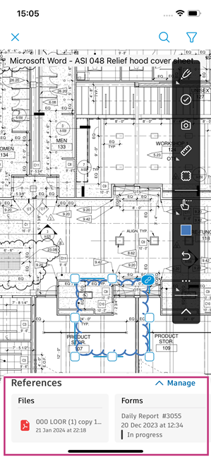

View, edit and delete mark-up references on Mobile
  1. Tap a markup. Markups with references have a badge at the top right corner.
  2. In the bottom drawer that appears, the references will be listed. Swipe right to view all references and tap on any of the project items to open it.
  3. To edit or delete a reference, tap Manage in the top right corner of the drawer.
    • To add more references, tap Add on the desired project item.
    • To delete a markup reference:
      • Android: Tap on the next to the project item and tap Remove.
      • iOS: Tap on the project item and tap Remove reference at the bottom right.
  4. Swipe down on the Reference window or tap away to return to the file.
