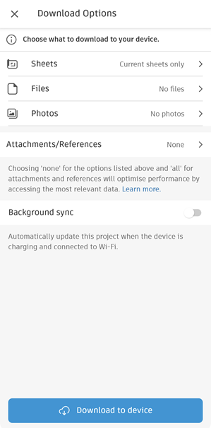

    You have the following download options. See Sync and Download Projects for more details.
    The file download options are only available for the first download of a project to your device.
    Tap Files and choose from All files and folders or No files.
    Even if you choose No files, you can change the download settings for individual files and folders at any time after the initial download.
  4. Select your download options
  5. Tap Download to device.

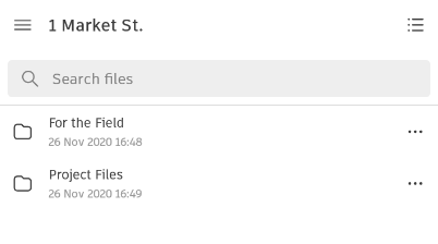

  3. Tap either the For the Site or Project Files root folder
  4. Tap the more menu next to either of these folders, any subfolder or individual file.

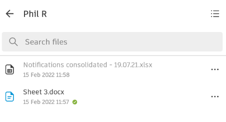

A green tick icon will display next to a downloaded file and next to any folder where all the contained files are downloaded. In the image below, Sheet3.docx is downloaded and is ready to view. The other file is dimmed as it is not downloaded and therefore can't be viewed.
Once a file has downloaded, it will open automatically.

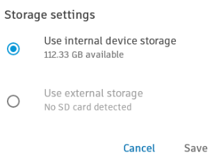

Note: You can change your storage settings and check how much space you have left on your device. Tap Storage settings from the more menu on the Projects page and select either Use internal device storage or Use external storage.
