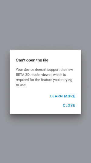

Android viewer error message On Android devices, you may see this error message if either:
  • An error was encountered while loading the viewer.
  • Your device doesn't support the new viewer.
  • The new viewer is not set as your default viewer. You tried to perform an action that requires the new viewer. This includes trying to view the placement of an issue or asset on a 3D model.
Try the following solutions one at time in this order:
  • Close the app and reopen.
    1. Swipe up from the bottom, hold, then let go.
    2. Reopen the Autodesk Forma app and try the action again.
  • Reboot your device.
    1. Press and hold the power button on your device.
    2. Tap "Restart", "Reboot" or "Power off" on your device.
    3. Turn the phone back on.
    4. Reopen the Autodesk Forma app and try the action again.
  • If you continue to see this error message, then your device may not support the new viewer.
    If you haven't already, you can turn on a setting to not use the new viewer by default. See Visit Switch In and Out of the New Viewer on Mobile. However, you won't be able to perform certain actions, as mentioned such as viewing issue or asset placements on 3D models. Review the Recommended Devices for the New Viewer.
