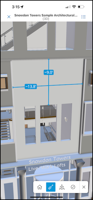

Straight Line Measure
There are two ways that you can take a straight line measurement:
Tap two points on your model to measure the distance between them.
Touch and hold to open a close-up of your touchpoint and let go to create the first point. Then hold and drag the point to measure a length.

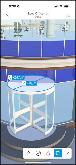

Surface Measure
Find the measurement of the edges of a flat or curved surface.**
Tap a flat or curved surface.
When a surface is tapped and the edges are measured, you may see various measurements depending on the surface, such as:
- Straight edges with lengths
- Circles with circumference and diameter
- Arcs with arc length. These can be circular arcs or generic arcs
- Ellipses with circumference, half major axis and half minor axis
- Cylinders and conic sections with two circles on each end parallel to each other will show a length dimension between the centres of the two circles
- Total area (flat surfaces only and shown in a black banner at the top of the screen)
The symbols next to the measurements will indicate the type of measurement (other than a straight line):
- C: circle and ellipse circumference
- Ø: circle diameter
- s: Arc length
- a: ellipse half major axis
- b: ellipse half minor axis
Here is an example where you can see C and Ø next to the measurements you receive after using the Surface Measure tool.

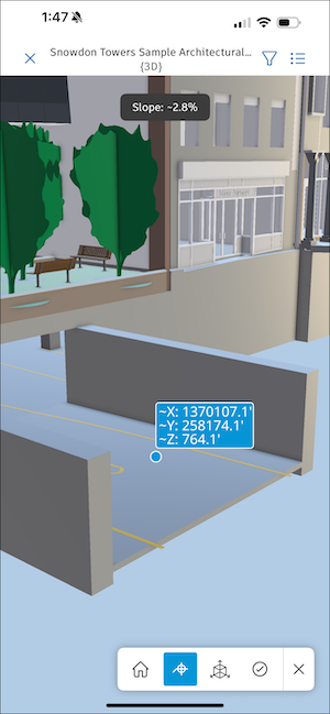

Spot Coordinate
Tap a point in the model to receive the:
Coordinates (X, Y)
Elevation (Z)
Slope (Shown in a black banner at the top of the screen)
Note: The slope will display ‘~∞%’ when the slope exceeds 10,000% such as for near-vertical surfaces.
Tip:
- Hold to open a close-up of your touchpoint. This will help you select the exact point you want to measure.
- You can drag a point to a new location and the values will update accordingly.
