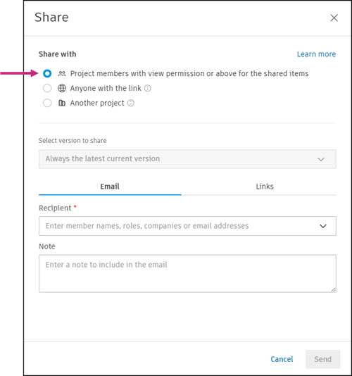

  2. Select Project members with view-only access or higher to email or copy links to files or folders.
    Share modal select project members
  3. (For files only) Select one of the following version options:

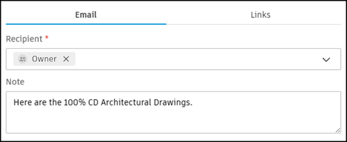

    • Email: Send an email with a link to the selected files or folders.
      Share link by email
      • Click the Email tab.
      • Click the Recipients field.
      • Select the tick boxes next to any user, role or company or start typing to bring up suggestions.
        Note: Companies or roles are only available to select if they have View folder permissions for the shared files and folders.
      • Click Save after your selections are made.
      • (Optional) Add a note to include in the email.
      • Click Send.
