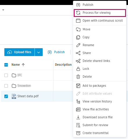

Process a single file: Right-click and select Process for viewing.
Process multiple files: Select multiple files and click Process for viewing.
