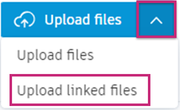

Click the drop-down arrow on the Upload files button.
Click Upload linked files.

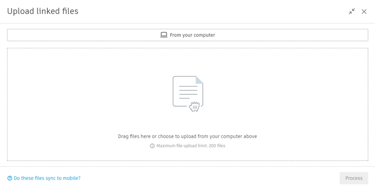

Drag or upload the host design file and its linked files from your computer.

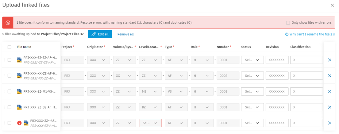

If the folder is naming standard enforced, a naming validator will open and check to see if the file names conform with the naming standard.
All files in the validator must conform to the naming standard in order to upload. You can remove any non-conforming files if they are not required.
You can't rename the linked files in the validator as this will break the relationship between the host file and its linked files.
You will need to:
When the naming validator opens, all file names will conform to the naming standard.
You can rename the related attribute values in the validator. This is useful if the file names in the validator all conform with the naming standard as the edited related attribute values will also be uploaded.

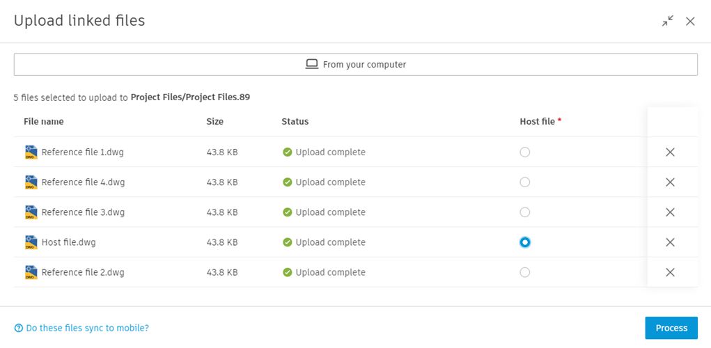

You may encounter errors in the Upload linked files uploader if:
Resolve any files errors as necessary.
Select your host design file. You need to do this in order to continue.
Click Process.

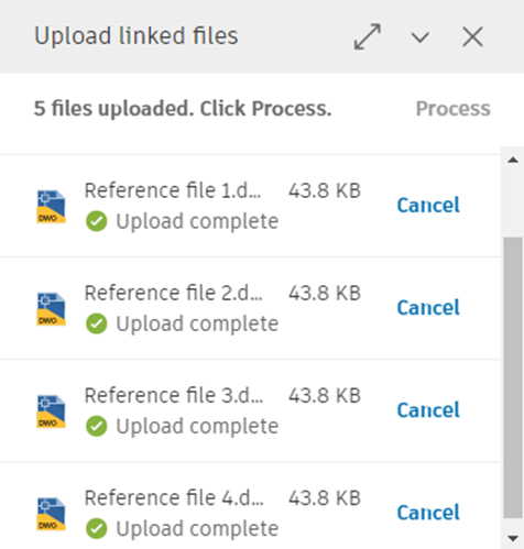

You can collapse the Upload linked files uploader at any time by clicking:

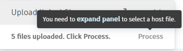

An upload panel will open in the Files tool. If your files have uploaded successfully and you've already selected a host file, click Process.
If your files have uploaded successfully and you haven't selected a host file, you need to click expand panel and select a host file before clicking Process
