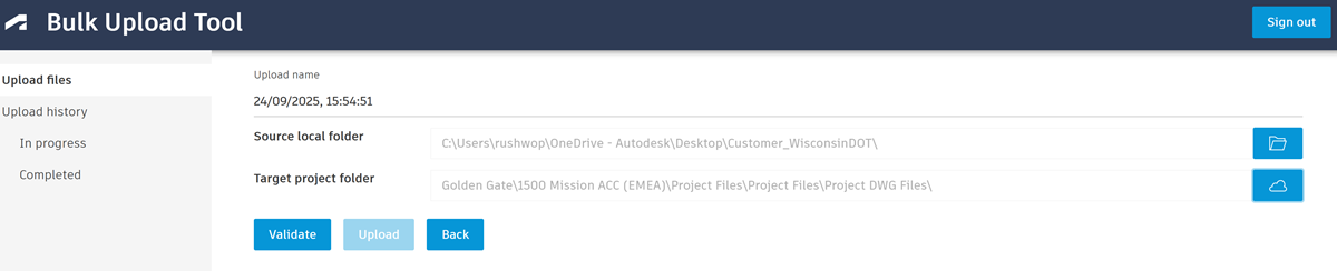

  1. Open the Bulk Upload Tool.
  2. Click Files without References.
  3. Click the Source local folder icon.
  4. Select the local folder containing the files that you want to upload.
    Note: The upload needs to include at least one file.
  5. Click Select folder.
  6. Click the Target project folder icon.
  7. Select the relevant account, project and project folder. You can't upload to a folder with a naming standard applied.
  8. Click Select.
  9. Click Validate.

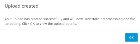

  10. Click Upload when you see Validation successfully completed, or choose to ignore the validation warnings.
    The tool will prepare and create your upload. This includes getting the upload ready, and storing the information in the database.
    When this is completed, you'll see the Upload created dialog.
  11. Click OK.
