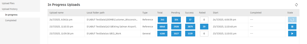

Once you've started to upload files with or without references, the details of the upload will display in the In Progress tab. Once an upload is completed, the details are displayed in the Completed tab.
The In Progress Uploads page in In Progress tab shows a row for each active upload session.
The following columns are included:
| Column | Description |
| Upload name | The name assigned to the upload by the user. If no name is provided, the date and time when the upload started will be displayed. |
| Local folder path | The local folder path selected by the user for upload. |
| Total | The total number of files in the selected folder intended for upload. |
| Pending | The number of files yet to be uploaded. This value updates in real-time as the upload progresses. |
| Success | The number of files successfully uploaded. This value updates in real-time. |
| Failed | The number of files that failed to upload. This value updates in real-time. |
| Start | The date and time when the upload began. |
| Completed | The date and time when the upload was completed. This will remain empty in the In Progress table. |
| State | Contains a button to pause or resume the upload. The duration of the pause/resume process depends on the number of files. While the action is in progress, a roller icon spins on the button to indicate the ongoing operation. |
You can click a single in progress upload to view the details of that specific upload session.
