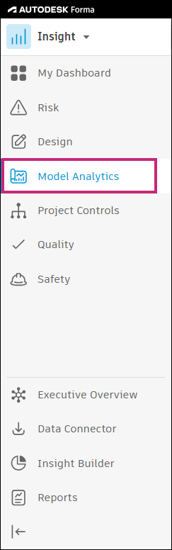

  1. From the product picker, click Insight.
  2. Click Model Analytics from the left panel.

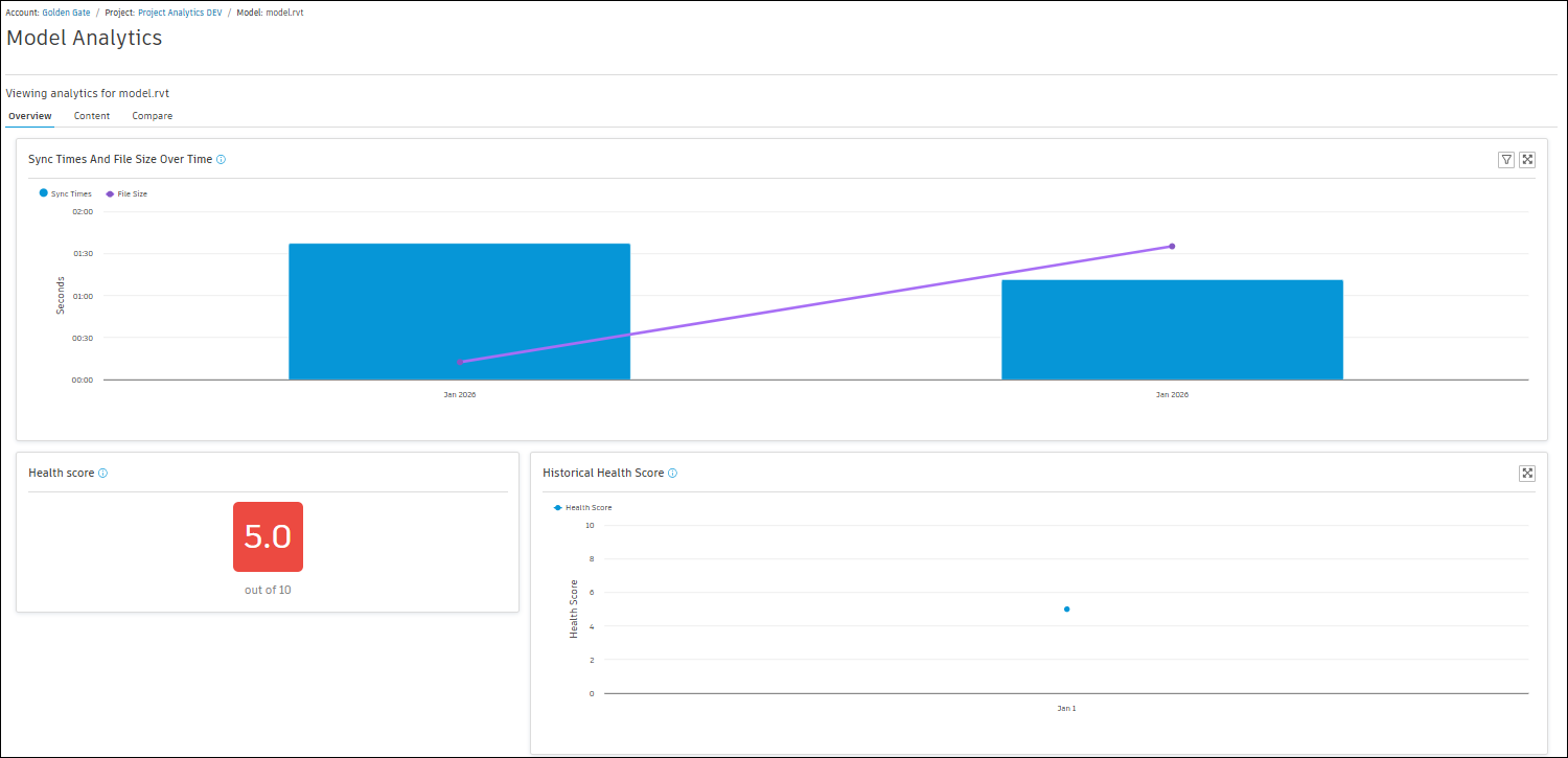

    • Sync Times and File Size Over Time: A visual representation of trends in sync times and file sizes for all models in the project over time to help identify potential performance issues with models.
    • Available Models: A table view of available models and their sync times. Click on a model name to open its details.
    • Health score: A score calculated by evaluating multiple model health indicators such as critical and non-critical Revit warnings, Revit links, CAD/import links, in-place families, plan regions and image imports.
    • Historical Health Score: A visual representation of the cumulative health score trend across all models in the project over time to help identify improvements or declines in model health.

    • Overview: Provides insight into sync times and file size over time, as well as health score and historical health score, health indicators and Revit warnings for the selected model.

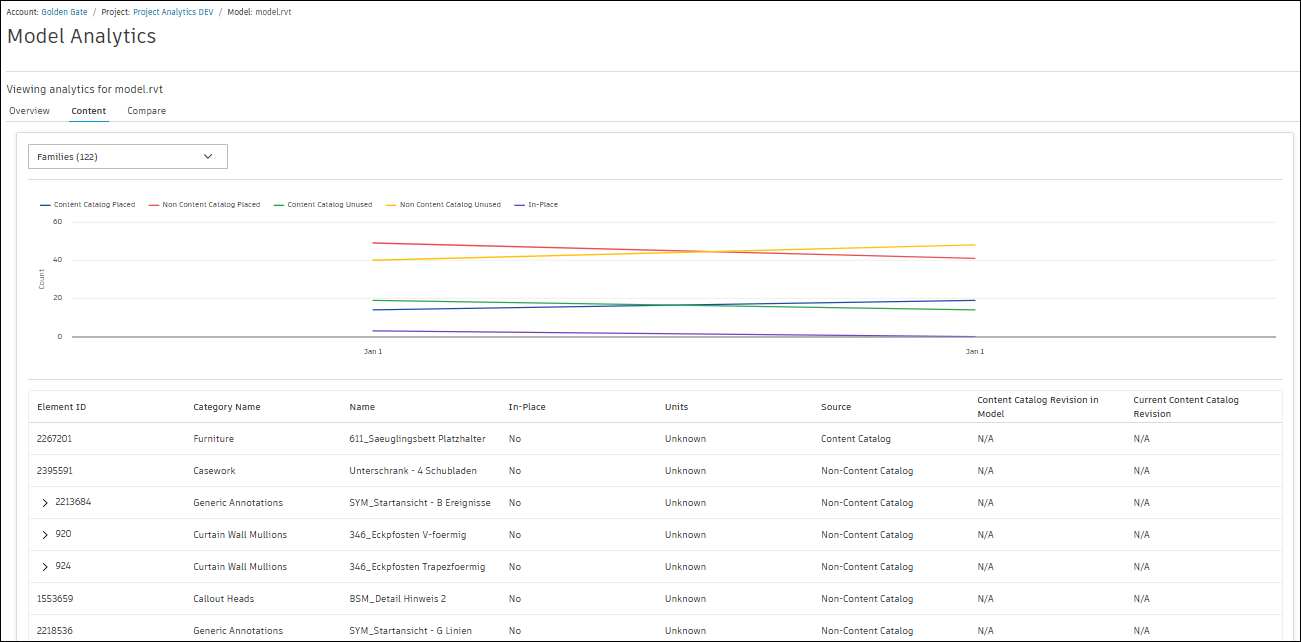

    • Content: Allows you to select the desired content type from the drop-down menu to review detailed data for that content type.

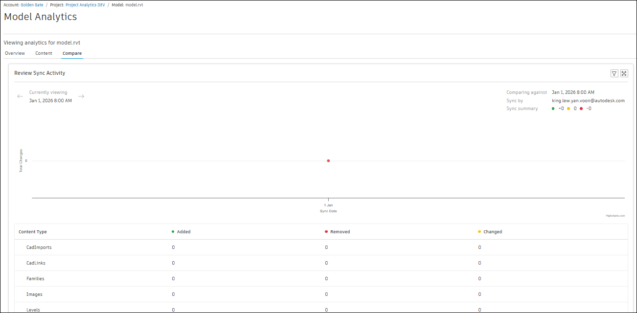

    • Compare: Shows review sync activity for each content type.
