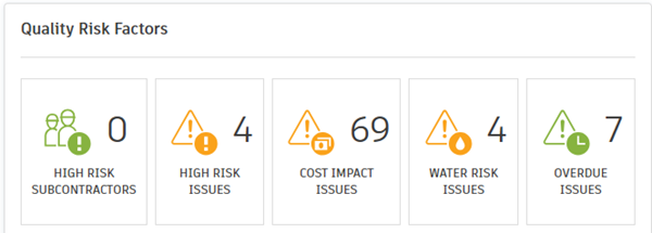

It is important to be able to quickly identify risk factors that might affect the quality or budget of a project. Construction IQ enables executives and project managers to assess project and subcontractor quality risks using the Quality Risk Factors card in the Risk feature.
The card summarises the high-risk issues for the project, specific risk categories such as water issues and high-risk subcontractors. It also includes overdue issues and checklist activity data.
You can click each factor in the card to view the issue and checklist data contributing to the predicted risk level.

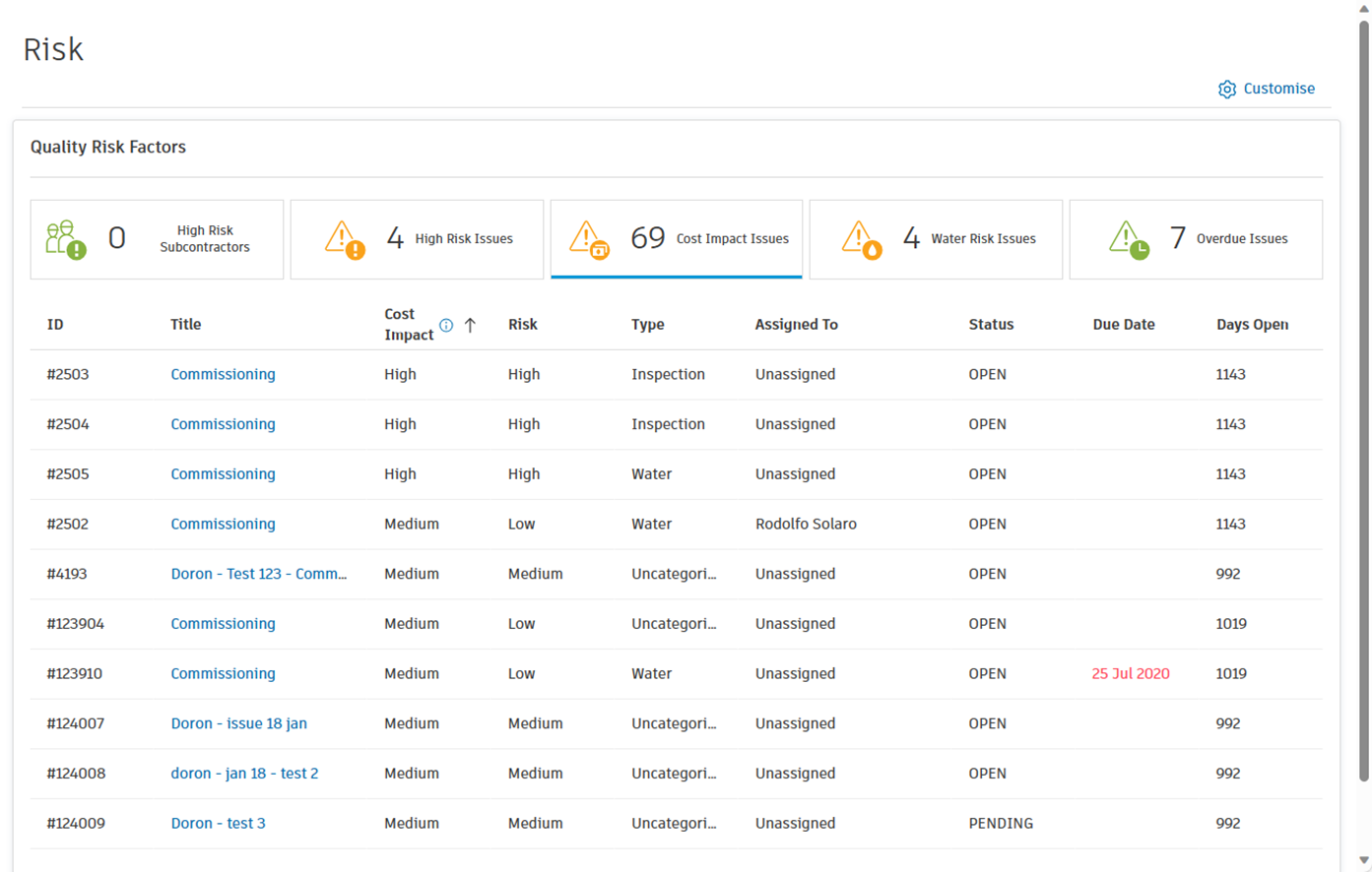

For example, click the High-Risk Issues factor to view a list of the project's high-risk issues. Click an issue's ID number to view its details and change the risk level or category as needed. The card is automatically updated to reflect these changes.
Cost Impact
Cost is an important aspect of any project. The Cost Impact Issues factor enables project managers to assess which open quality issues have the highest cost impact. They can then prioritise these issues to avoid going over budget (and possibly affecting project outcome).
Construction IQ reviews a project's quality issues, evaluating direct costs of materials, labour and equipment, as well as indirect overhead costs, to estimate the overall cost to fix them.

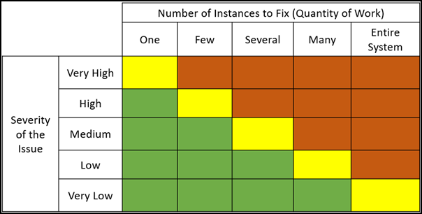

The issues are then ranked as high, medium or low based on issue severity and the quantity of work required:
Green = Low, Orange = Medium, Red = High.
